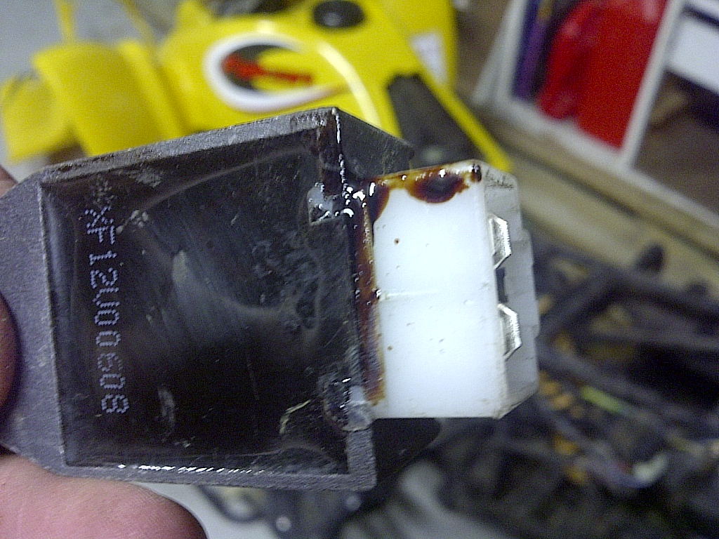

I think this is a resistor and shouldn't be leaking a sticky brown smelly fluid.
This maybe the issue.
Come to think of it, I'm pretty sure nothing should be leaking a sticky brown smelly fluid...
Thoughts....on the suspected issue?

Correction, its a voltage regulator. Those in the know, would this cause a short and the fuses to blow?
2007 ZX6 - Road bike
h.b.bear
- Posts: 1175
- Joined: Wed Oct 27, 2010 2:21 pm
- Location: Tamworth NSW
Re: Any auto electricians on deck?
probably would if all melted inside
- StuMiller
- Posts: 1360
- Joined: Thu Jun 22, 2006 12:02 pm
- State: Tasmania
- Location: Hobart, Tasmania
Problem solved. It's up and running.
