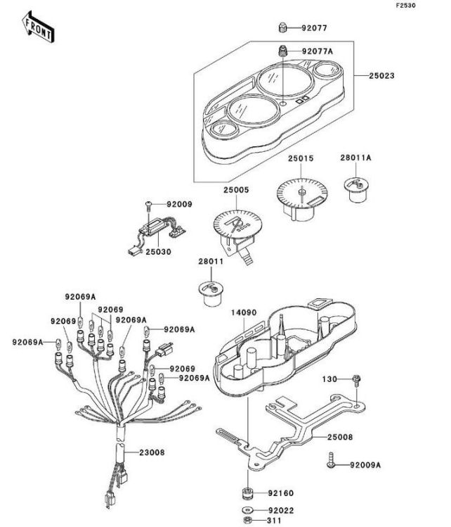

Re: Bit of HELP!!!! needed here
This is from the ZZR600
mototech website has a few exploded views like that :D

Seiko,
Thanks for that, had the same pic but was unsure about unscrewing the button on the trip metre, :? but thought, well its stuffed any ways, so applied a bit of extra pressure and it screwed off. :oops: :oops:
