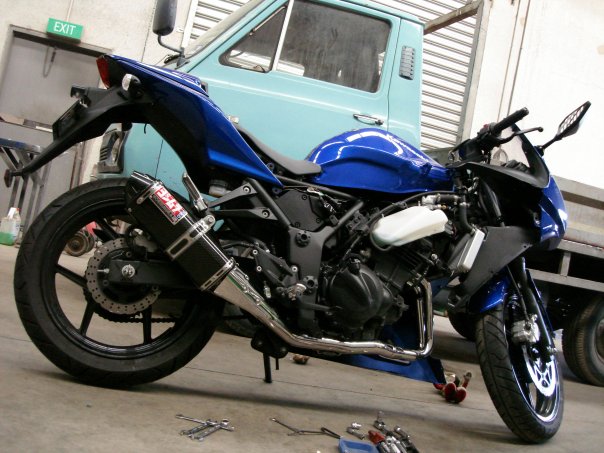

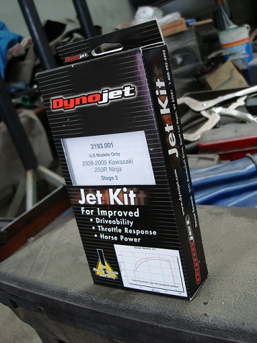

heyz crew, thought i'd just show off what i was doing last weekend ..

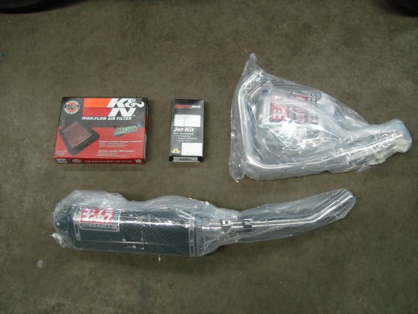

- the bits .. dyno jet kit, k&n filter, full yoshi cf exhaust..
- 12938_161476934890_523979890_2797971_8380602_n.jpg (48.74 KiB) Viewed 2170 times

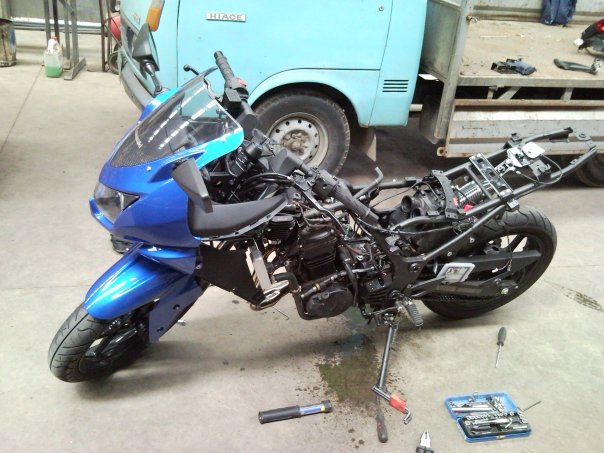

- stripped .. from head to toe
- 12938_161470899890_523979890_2797956_555558_n.jpg (68.46 KiB) Viewed 2170 times

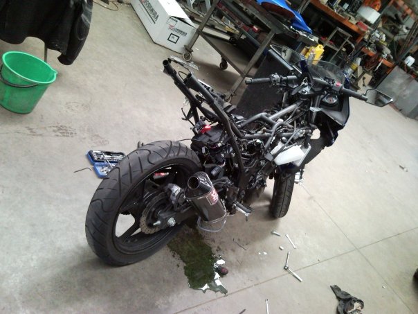

- stripped .. from the back
- 12938_161470889890_523979890_2797955_1728493_n.jpg (62.56 KiB) Viewed 2170 times
- .. and here's the carbon fibre yoshi

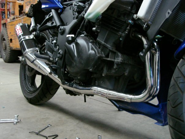

- the extracters - chromy and shiny .. takes a bit of modding to get on
- 12938_161476949890_523979890_2797973_5900495_n.jpg (56.83 KiB) Viewed 2169 times

Very nice but I think you would have got away with not stripping the entire bike

Re: New bits until I can afford a bigger bike
thx for the comments guys..
after a one hour ride, the headers changed to a shiny brown fairly quick. but yea, it was surprisingly loud - sounds awesome. i was going to stick the silencer in but thought the noise will only alert drivers to my presence on the road. fitting took some fiddling, had to split the pipes about 15mm apart before the flanges line up.
with just the exhaust, it got rid of a flat spot from 3.5-7500rpm. with the jetting kit as well there was a slight gain throughout the whole rpm range. also, with the jetting kit, the idle was smooth as.
regarding the bit about stripping the whole bike, well, it was the only way i could get the carby out. if someone can show me another way, it'd be great (i'm such a n00b).
in case anyone wants to know, dynojet supply 94 to 100 thou jets with their stage 2 and recommend using the 98 thou with exhaust+intake mods. however, on closer inspection, the oz-delivered 250r already comes with the same size jets. you need to use the 100 thou to get any difference. incidentally, the plug mentioned in the instructions that covers the adjustment screw is not present on the oz-delivered - bonus!

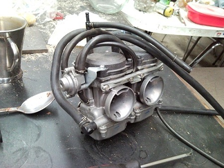

- Had to strip the bike down to fit this...
- DSC04494.JPG (85.94 KiB) Viewed 2004 times
- ...into this...
- SNC00543.jpg (80.05 KiB) Viewed 2003 times
