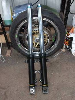

And here's the legs all set to go.
I'm taking your advise Phil, it's 2 yrs since I had the racetech springs and the valves done so I'm getting the forks serviced.
(new oil and seals.) To save some dough I took the legs out and will send them off to my mechanic. I figure it's no use having the suspension upgraded ansd not keepng it serviced. Thanks for the tip.

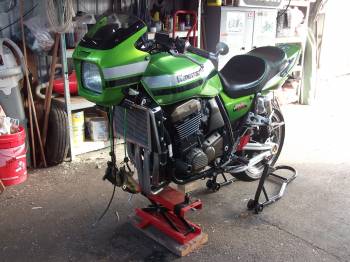

billwest wrote:All good sofar - everything is apart. Cause of oil seal failure - crud under the dust cap, must have worked its way down.
Anyway, waiting on Racetech springs.
In the meantime, thinking about reassembling. There are 2 copper/brass bushes each side which the Kawi manual says must be replaced. Is this strictly necessary?
Thanks,
Bill.
Bill those bushes are teflon coated on one side, one on the inside and one on the outside only replace if the teflon is showing sigs of wearing through( IE. little spots of brass showing through the teflon.)

Re: Leaky fork on the Rex
Post by billwest »
I left the bushes as they were. New oil (10Wt, motul), new seals, dust covers, crush washers at the bottom, and of course the Racetech srpings (1.0). What a difference in ride! The springs are longer than OEM, so had to cut new spacers, which I made 5mm longer than really required. Preload is on 6 rings showing, and at my 100kg seems just right. Rock steady. Now waiting for the Gazis to replace the rear springs.
You're right about the oil - it was rank. Had never been changed in all of the 102,000km.
Also put in a Dynojet kit, which does very well. Slight flat spot at around 3000rpm, will need to put a washer under the needles.
Next: the ZZR1200 fork oil.
Bill.
