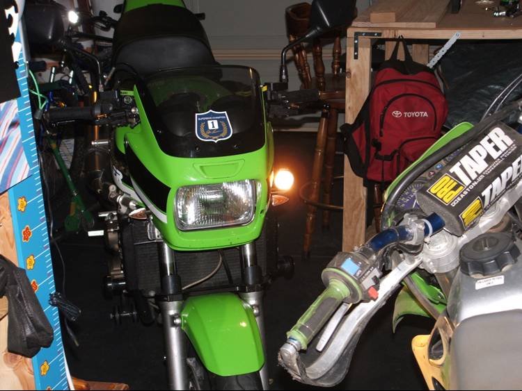

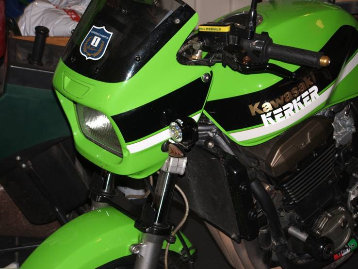

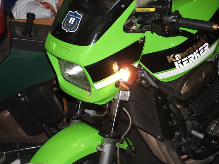

I've used just one horn, probably out of a dual set-up (just bought one). It sounds much louder than stock so I was happy :D . You're righ though - they do sound better in pairs.
I mounted a small "PIAA" light that I bought overseas just above the LHS indicator using an L bracket. I mounted the relay in the fairing.
Cheers,
TC
L Bracket just above indicator
Switched on
Switched on
Switched on
Switched on
