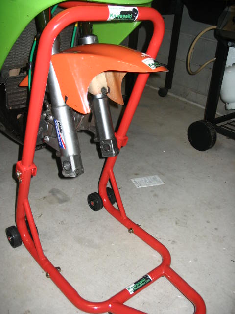

this is mine now that it is all together.
it may take bit of a sicence lesson to explain how it doesn't fall down in a heap, but remember one thing; MAKE SURE THE REAR END IS PROPERLY SUPPORTED (sorry about the caps & colour :lol: )

frogzx12r wrote: Also I know we are ozzies and dont read instructions, but in this case they were fairly explicit in how to use.... :wink:
ermmmm....no instructions came with it Frog, but thanks anyway ;)
Thanks for the pic Mitch. we'll see how we go!
