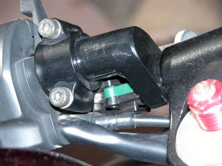

i have ordered a pair of heli-bars for my '03 zx12.
i notice the weighted hand tingles on slow trips.

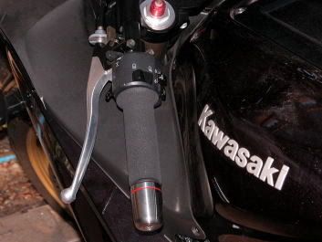

Re: 03 mods
matezx12B2 wrote:fitted the heli-bars today and some foam gripcovers.
a nice improvement. no hand tingles yet and less of a reach forward.
any pics?
