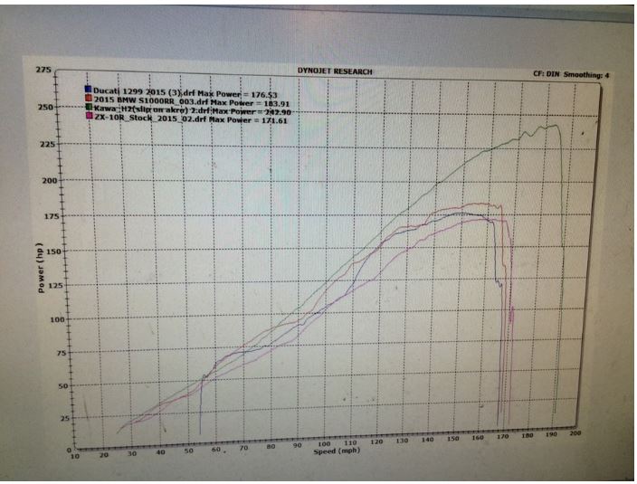

Here is a guide comparing different bikes on the same dyno,looks like the H2 has it in spades
h2 dyno comp.JPG (67.94 KiB) Viewed 8486 times
Mister_T
Posts: 205
Bike: GPx750
Re: H2R world record
Post by Mister_T »
The H2 certainly has top end in spades.
I think people who are familiar with dyno sheets would also be impressed with the straightness and smoothness of the H2's graph.
That suggests the power would be predictable and relatively controllable. A credit to the the developers.
By virtue of the forced induction, I guess the H2 can run milder cam timing than a naturally aspirated engine, making resonance tuning a bit less critical.
I see the line gets a bit jumpy at the top end. Is there a bit of tuning to do to suit the Akro? Or was it a traction issue?
