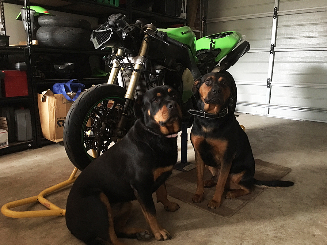

Today I started prepping the bike ready for the front end rebuild, including removal of fairings so I can support the bike for fork removal. Of course I had a little help from my friends...
ZX10 stripped 22/01/16

love the alarm system :kuda:

Kwakked Up wrote:love the alarm system :kuda:
Thanks, they are great & awesome guard dogs.
