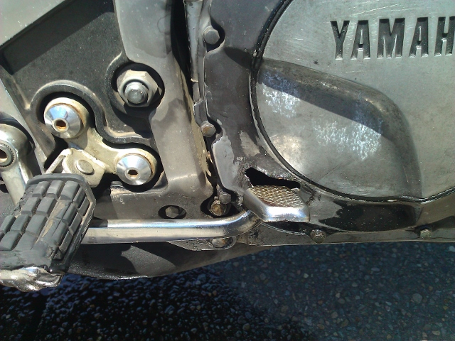

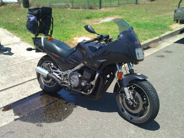

My old FJ has developed an oil leak...... :cry: :cry: :cry:
Some idiot courier reversed into it on the left and pushed it over of the stand to the right :x :x
Apart from the usual blinkers, lever, fairing and exhaust, :x it pushed the rear brake lever into the side cover, the piece of alloy is inside the crank somewhere :shock:

Mate of mine had the same happen on his fj- fixed with liquid steel and some aluminium can. At least it didn't fall LEFT- sidestand on fjs bend the frame when they fall that way. :(

Looks like it had a clutch let go at one stage .. ebay may have a cheap cover . I would drop the sump just to be safe for any fragments .
Edit sorry looks like its been dropped , hope you nail the carnt .

MAXUMIS wrote:Looks like it had a clutch let go at one stage .. ebay may have a cheap cover . I would drop the sump just to be safe for any fragments .
Maxumis, why you think it may have had the clutch let go? :?
I was just wondering, it seemed to be working ok

rip that clutch cover off and the broken piece will just be sitting inside the housing. Should be easy to fish out.
