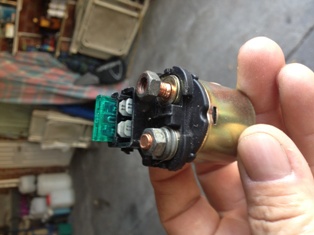

The 2 threaded posts on the regulator, just bridge them carefully & briefly to see if the starter kicks. I'll try and attach a picture.
- zxr 750 94 121231 012.jpg (27.77 KiB) Viewed 4502 times

Got ya, thanks for the pic. will give that a shot and see how she goes
