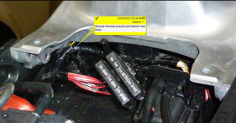

Ref: http://www.zx-10r.net/forum/showthread.php?t=105413
This issue also appears to apply to the Australian ABS model: ZX1000KBF.
Refer to #1 for a pdf of the letter and #26 for my simple solution. It will be interesting to see if Kawasaki Australia apply this recall.
Quantum
Posts: 2
Joined: Mon Mar 07, 2011 3:39 am
Re: ZX-10R 2011 ABS 2nd US Recall - Wiring Harness
Post by Quantum »
Re:http://the910ths.com/Manuals/2011recall2.pdf, the Australian model definitely has the same issue. No damage to the harness but I now have peace of mind for having changed the screw and rerouted the harness:
Re-route w comment.JPG (90.25 KiB) Viewed 1058 times
