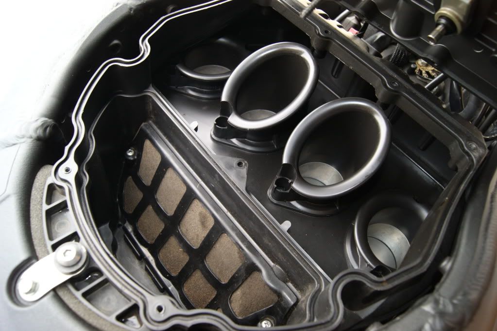

After seeing my old stock filter its obviously working, in the end i went for a stock kawa filter maybe if i did as many Kms on the bike as the Wife does in the car a washable filter would be beneficial, but not when i know that the stock filter can allow enough air to make 200HP with ram air and still filter all the crap out.
Hope this essay helps some one make a educated choice in the future.
Pretty clean inside
