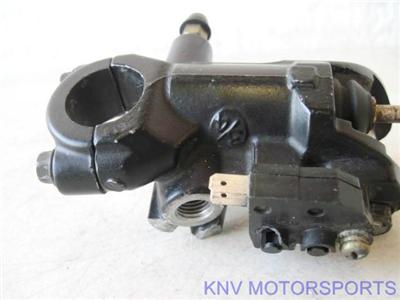

Does anyone know what size (bore x stroke)the stock Nissin radial brake master is on the late model zx14 and zx10?
I've looked everywhere but can't find any specs...

Thanks Wattie, have searched but seem to get different answers?....some have said 16mm, others 19mm?
There's a stamp underneath that says 11/16 .... this translates to 17.5mm....not sure if this is the size or what, quite a few of the late model Nissin MCs have this stamp
Re: ZX14R brake master size?
yeah thats the size mate.
the brembo's are 19mm. conventional 04 zx10r ones are 14mm i think?
Been lookin into this again for Russ.
The zx10r radial master cylinder is about 17.5mm (11/16).
The 04/05 zx10r non radial is 14mm.
(I have both in my garage)
I suggested to Russ to get a gsxr master cylinder as they are 19mm - stamped 3/4..
