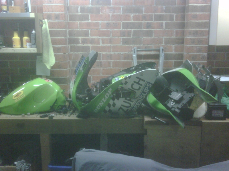

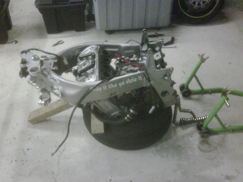

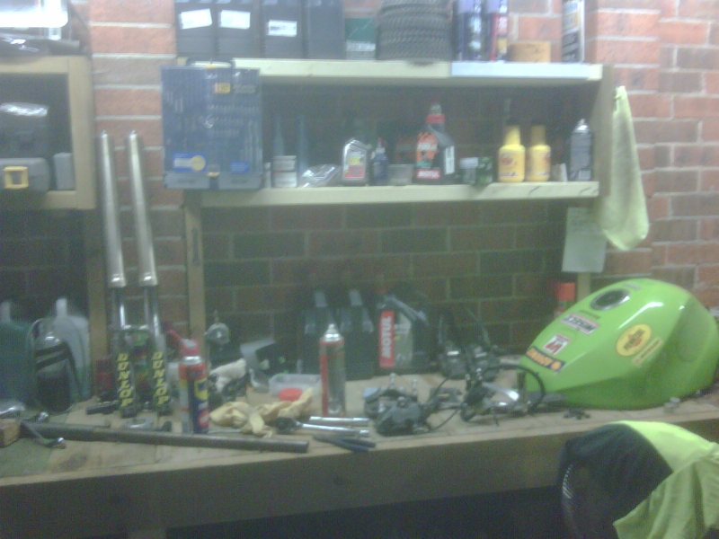

After the hassles at PI last year I really need to get my Mutant rebuilt into the new frame before November so I decided to skip next Saturday's OP trackday and start the rebuild. It has to be ready for EC on October 10th so I don't have time to fart-arse around either, but while it's a part I'm making a few tasteful modifications too. At this stage it's stripped down to the bare frame with an engine in it and a pile of parts.
The plan for mods is:
zxr750r (M1) frame with the swingarm pivot located 2.5mm up and 2mm forward
zxr750 J swingarm with zx7r P alloy swingarm sleeve and alloy spacers
zx7r P forks and lower triple clamp. Forks to be re-valved and re-sprung by Terry Hay
zx7r P 6 pot callipers. Bendix race pads
520 chain and sprocket - gearing to be determined
Brembo radial master cylinder
LED warning lights
Push-button starter
Over the last few weeks I've also done:
Quick action throttle
Dynatec coils, 8.8mm HT leads and iridium plugs

The rebuild started out pretty quickly - by the end of day one the engine was sitting on the floor waiting for re-assembly, and that's pretty much where the easy bits finished. The 900 engine is a *very* tight fit into the braced M1 frame, and for a while I thought I was going to have to take an angle grinder to the gusseting that's welded into the frame. In the end I got the engine in, but it's so tight that I can't take the rocker box off without dropping the engine out completely - makes those pesky 12's seem pretty low maintenance now.
With the engine in I fitted the J model swingarm up using the alloy P model pivot sleeve with the TKA developed swingarm pivots - up 2.5mm and forward 2mm and discovered that at some point in the stroke the swingarm touches the block. As it turns out I think it only touches outside of the regular stroke with the shock fitted so it should be OK.
Once the swingarm was in I could start fitting everything else back up - I took the opportunity to tidy up the wiring even further, removed the ignition switch and replaced it with a regular switch, wired up a neutral light, re-connected the temp gauge. I also added a right-hand switch block from a later 600 as the stock one was integrated with the throttle housing and the throttle was replaced with a quick action jobbie.
Added a BMC air filter (stock only, they don't do a race filter for the old 900s), fabricated up a bracket to mount the dynatech coils behind the headstock (because there just wasn't room to relocate them to the middle of the bike.
On Friday I picked my P model forks up from Terry Hay - they'd been off to be re-hard chromed as the chrome above the dust deal but below the oil seal was damaged (couldn't see it in the pics when I bought them). Terry also modified the forks using caps off a late 90s R1 (or FZ1). With the different caps the fork rods were machined down 20mm and I now have "proper" preload. Along with the new forks I bought the later model 6 pot callipers too, and a set of Bendix race pads (thanks Sam). I've also had a Brembo master cylinder sitting in the garage for a while and decided I'd fit it up along with the rebuild. I've also replaced the bulky rear brake reservoir with a piece of clear tube and fitted a keyless fuel cap. Finally, after a rapid dash around the city on Friday afternoon I got my new gearing sorted too and it's now running a 520 chain with 15/45 gearing.
To top everything off I've glued up the little cracks in the double bubble screen (cause I can't find a non-drilled replacement anywhere), cleaned everything up and finally re-numbered the bike to #3.
