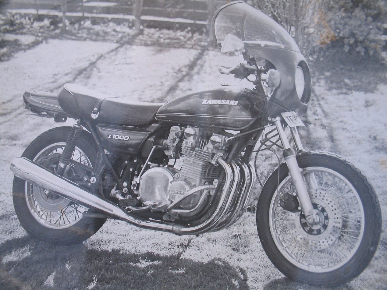

Had a shot of the bike to show you, but it's apparently too big (1.2Mb).
I'll get another one and try and make it smaller.
The bike's it's in good nick - fortunately, Adelaide is quite dry, and it has been in a shed, with a cotton sheet over it.
I was going to just put it all back together, and bugger how it looks, but now I'm figuring I'll get the frame sprayed and maybe even bead-blast the engine. And a new paint job. I mean, while it's apart...

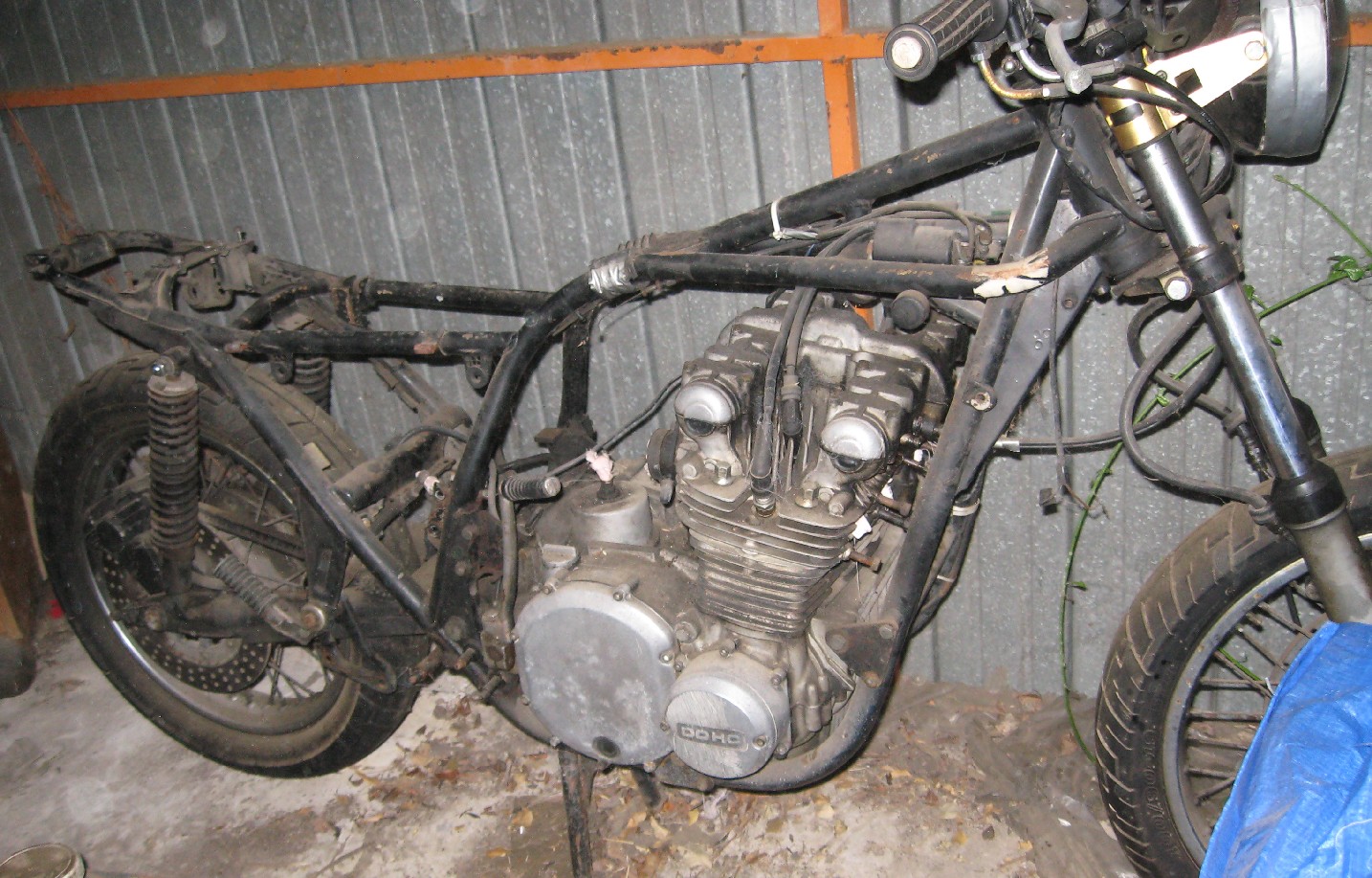

Okay, thanks for the photo tip. I'll see if this works...
paul w
- Warming up
- Posts: 83
- Joined: Fri May 01, 2009 4:23 pm
Re: okay, let's get it back on the road.
The rest, the tanks and such, is nearby, all covered.
