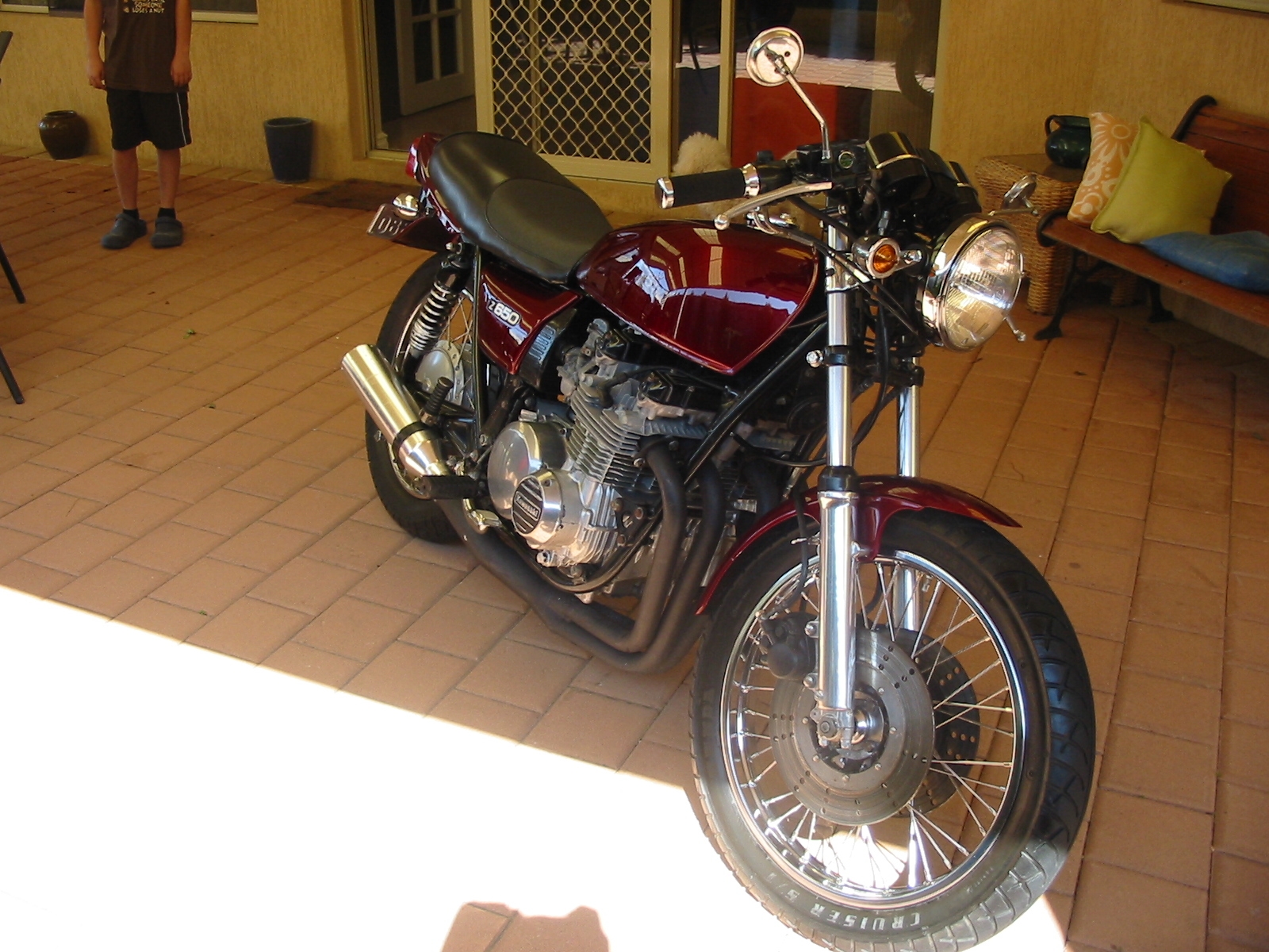

Finally have completed the instalation of my spoked rims to my Z650. Well its a Z720 now. Ive installed a new waeco kit through and its done a worls of good. The change over was difficult getting parts from ebay and east was difficult some costly purchases were made which didnt fit the bike...
In the end I bought a whole z650 B 1978 and robbed from peter to give to paul. Thanksto everyone with the tips and advice much appreciated Regards Infekted

Re: Z650 wheel conversion Alloy to spokes help
Wow
That's a bloody neat looking Z there, the spokies were worth the effort - they look spot on !!
Ever thought of upgrading the calipers? You won't be sorry if you do.

Any recommendations on the caliper ugrades. I couldnt use the F off the original series as they didnt match the 78 B series forks. Puke! I just rebuilt them.Kwak addict wrote:WowThat's a bloody neat looking Z there, the spokies were worth the effort - they look spot on !!
