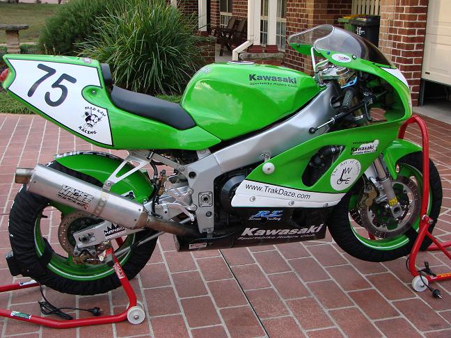

This is what I attempted to race for a couple of years.
93 zxr750r M1 - Limited edition homologation special... Didn't go any better than a good stocker though (it was pretty stock) and was a lot of trouble..
Had an offer I couldn't refuse so I sold it earlier this year..
