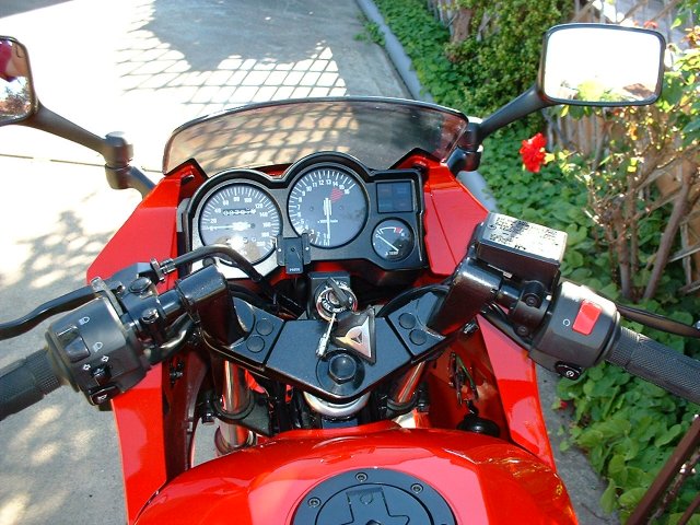

FWIW I mounted my computer to a slice of broomstick painted black with the flat side glued to the dash of the GPX and the curved side glued to the computer mount :lol:. That way the computer could still be removed when leaving the bike in public and changing the battery. Here's a pic with the mount between the speedo and tacho:
Bike dash.jpg (91.58 KiB) Viewed 3379 times
...it'd be a lot easier on the Hornet, plenty of spare handlebar 8)
Thks, Mick
