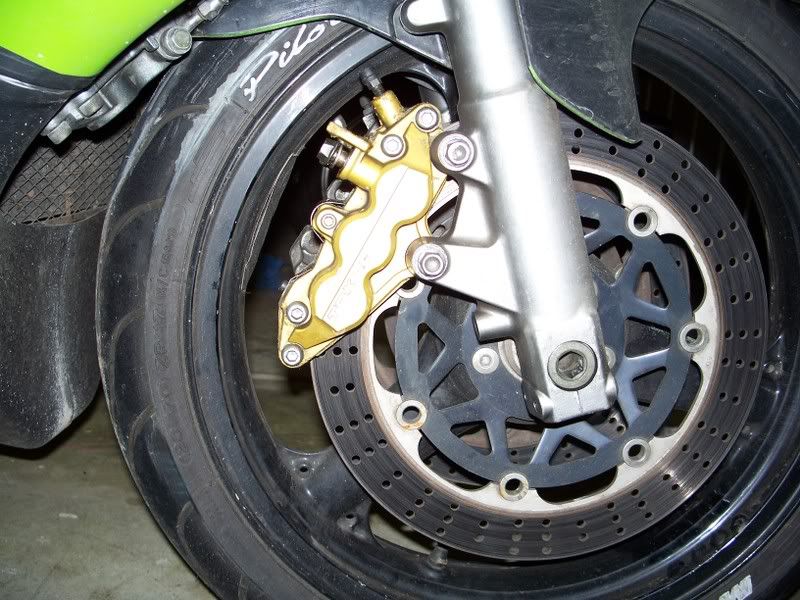

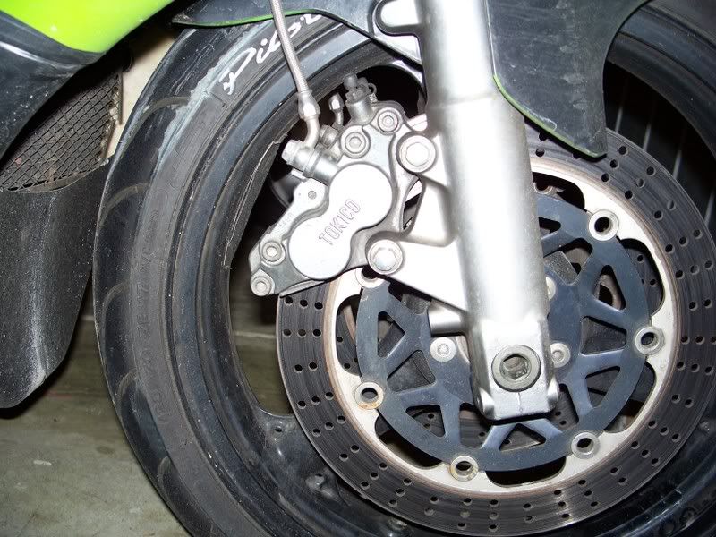

Alright guys, got a set of K2 calipers from Vic wreckers yesterday, $125 each. A mate is making me some spacers so I can use 8mm(zook sized) bolts in the10mm) kwak caliper bolt holes. Should have the whole shebang done by Saturday, then its stop city!!!
Before:
After:
