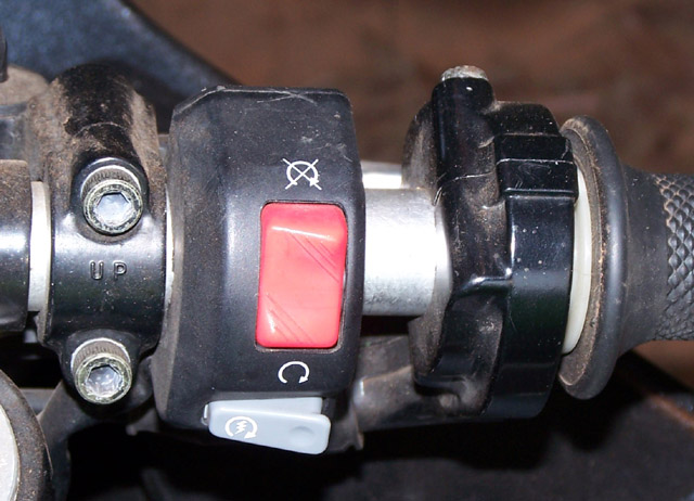

Not sure how the 636 is set up, but if it's anything like the picture, it'll be loose or busted. If it's broken it will be pretty obvious.
In the attached pic, the throttle cable/grip doesn't go into the switchblock, and can be moved up or down the bar to taste with no locating pins.
