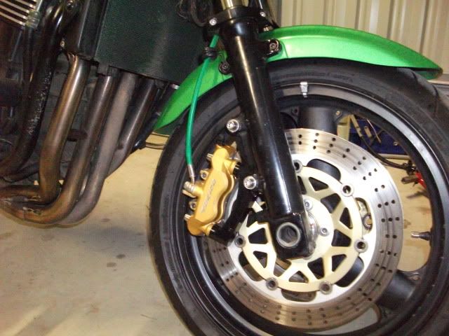

plane
Posts: 307
Location: Whitsundays
Re: Radial calipers & M/Cyl on REX
Post by plane »
Calipers have arrived, new pads in, brakes bled. Will have a test ride as soon as I have the rest of the bike back together! At last I have lever pressure!!
Happy happy, joy joy!
Cheers,
Pete
Live Fast, Die Sideways
plane
Posts: 307
Post by plane »
Victory!
Cheers,
Pete
