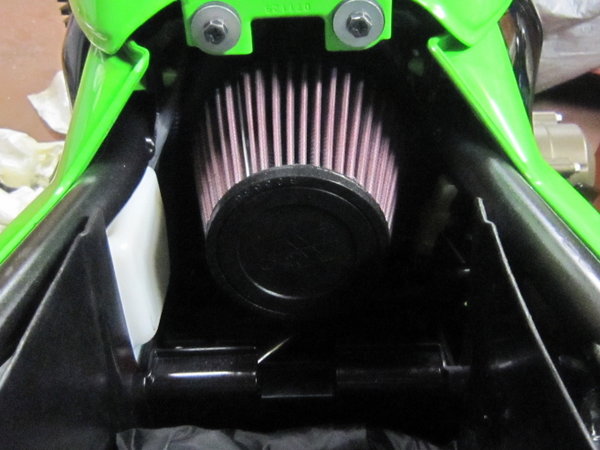

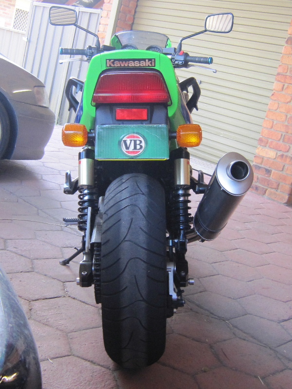

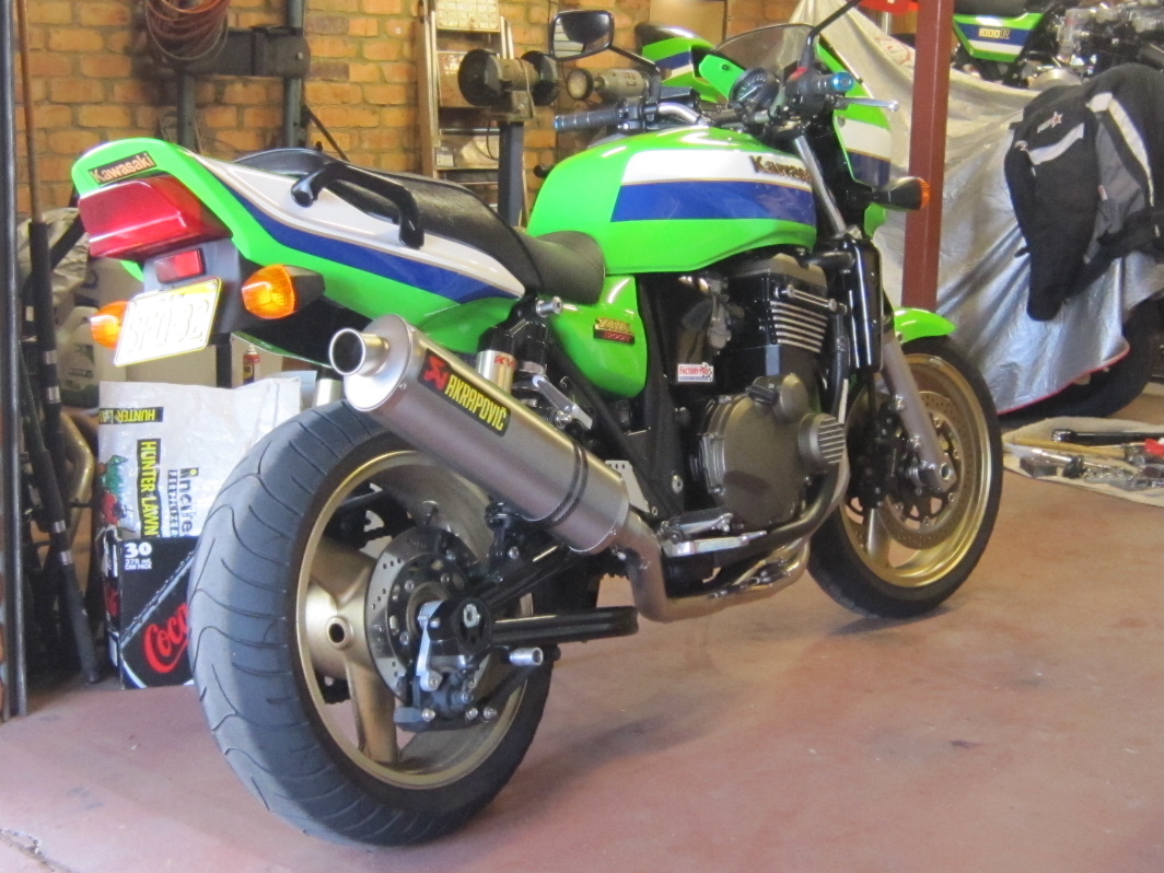

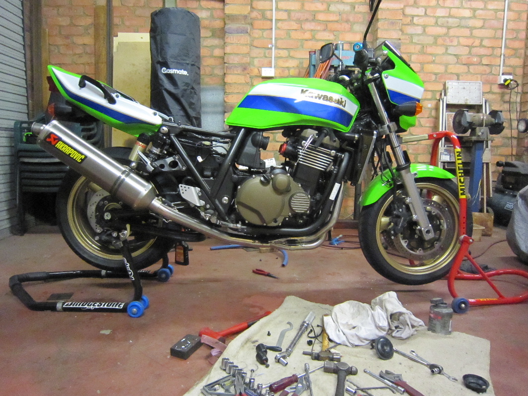

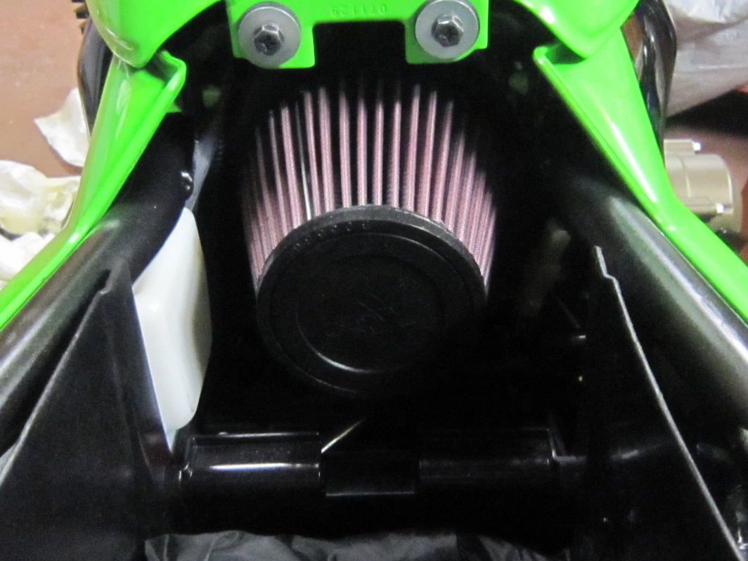

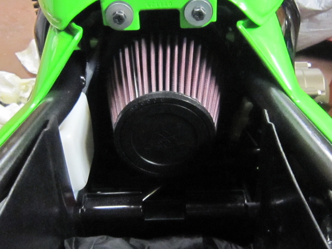

Here you go, Fitting the pipe was a beeze. Very well made and everything went together beutifully. It's nice and light as well.
The air filter ( K&N) single tapered one and jet kit went good as well but I think a Dyno run might help get the best out of it all. I just went with the Factory Pro instructions recommended for jetting and although I think I could be a little rich in the pilot jets. Mains feel good for roll on at low revs. Unforunately I only got a short ride in yesterday arvo to test her out, and today was raining all day. Sounds awsome.... not too loud when your just cruising, but when you open it up, a nice sharp howl soon comes in and increases to redline.
I am impressed how much these simple mods bring the ZRX alive.
I still have to put the +4 advancer in and I am hoping that might crispen the rev range up a litle bit more.
