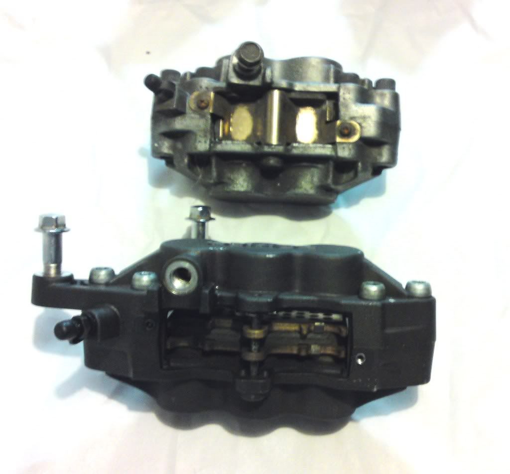

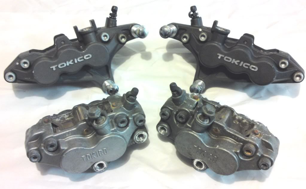

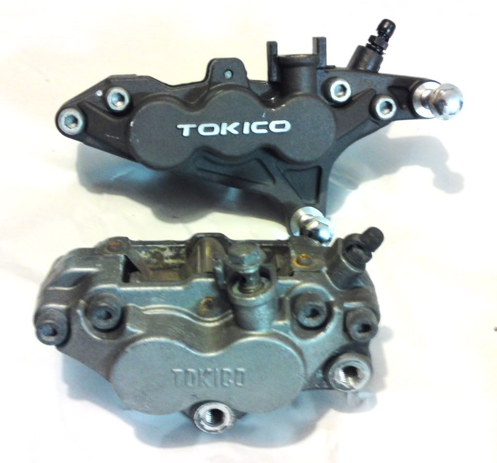

A bit of a comparison between the ZXR & ZX7R front calipers>
I will find out the approx weight difference tomorrow, You can certainly notice how much lighter the ZX7R calipers are just by picking them up though
