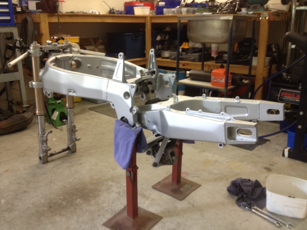

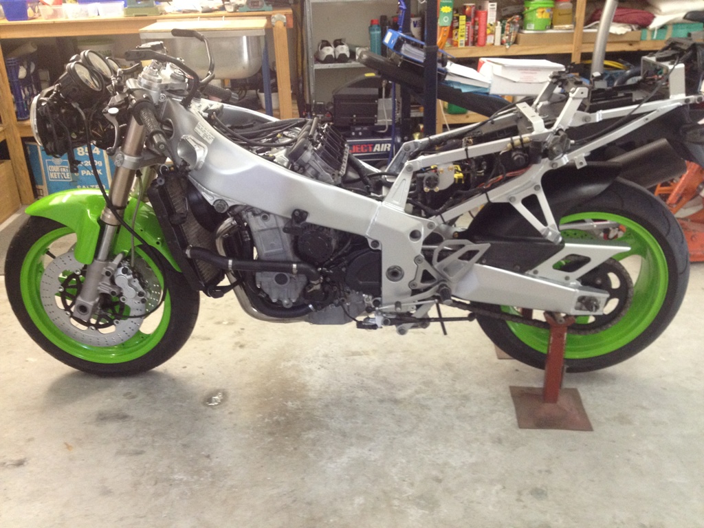

- Re painted with Subaru Silver Acrylic Lacquer & cleared over, good colour. Forks rebuilt, new seals etc, swing arm bearings greased up & seals.
- Phone Pictures 023.jpg (221.79 KiB) Viewed 10928 times

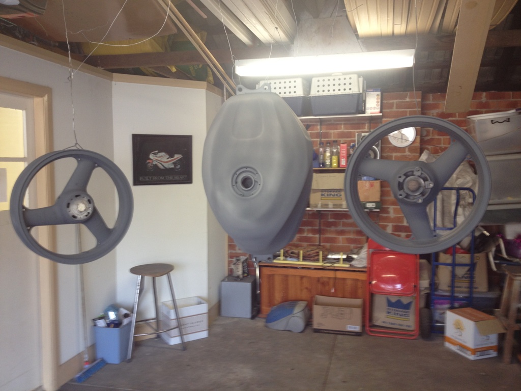

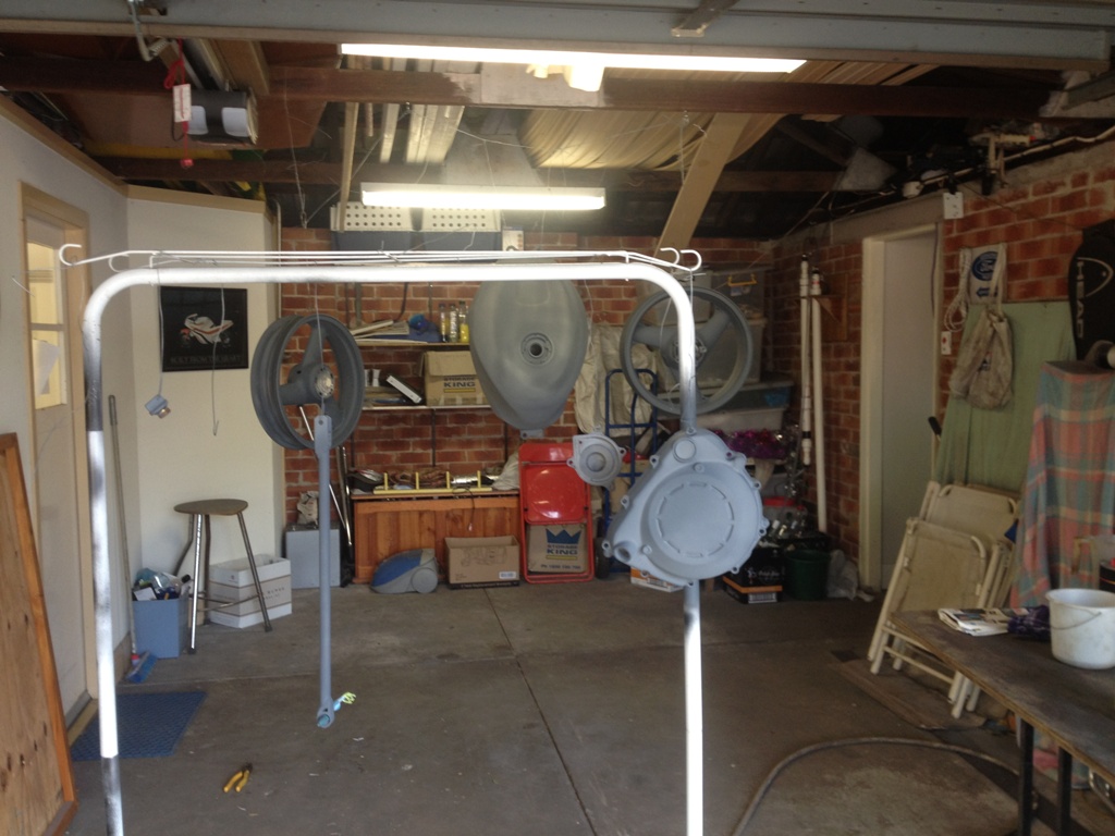

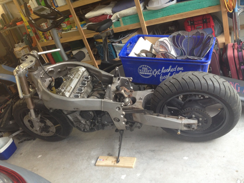

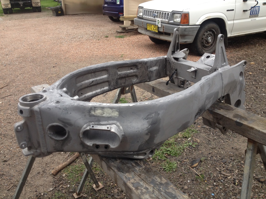

- Stripped down in the cabinet & etch primed in the booth / her garage.
- zxr 750 94 007.jpg (201.67 KiB) Viewed 10928 times

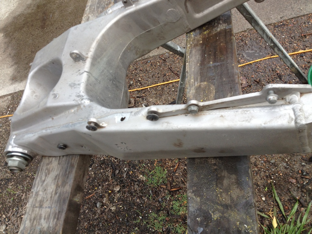

- All the frame, brakes, general brackets & everything into the sand cabinet, stripped & primed ready for paint. Better than new as no factory parts get a primer coat just straight on with the colour & bring on the corrosion.
- zxr 750 94 008.jpg (220.76 KiB) Viewed 10928 times

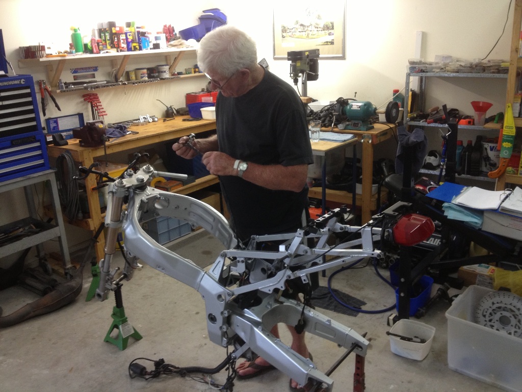

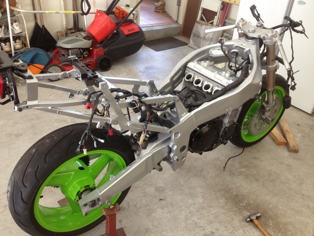

- Dad & she's coming back together.
- zxr 750 94 011.jpg (249.58 KiB) Viewed 10928 times

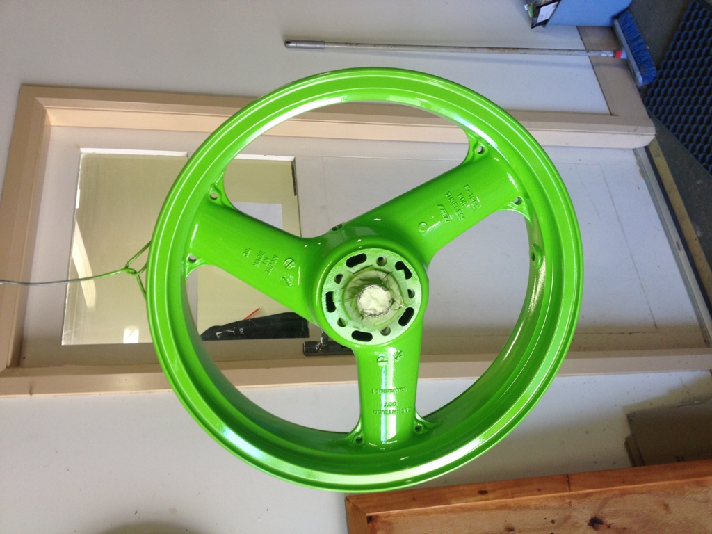

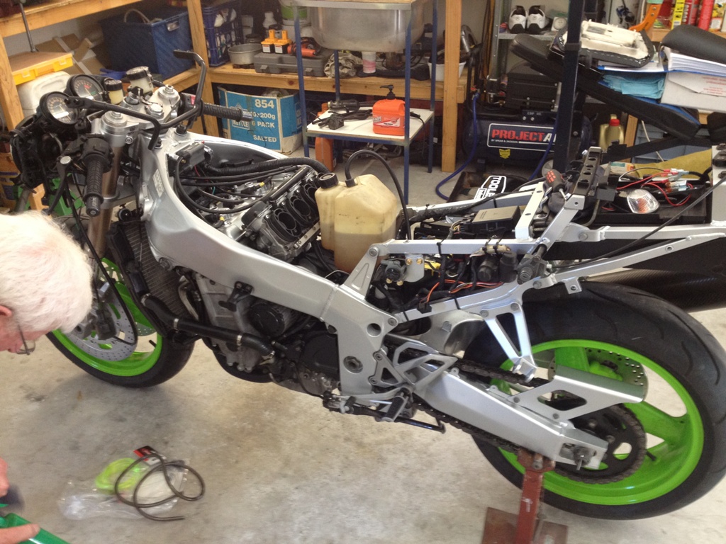

- Gone are the black wheels & bring in the green, it was the only Kawasaki green listed in 2 pak & nice colour. They came up like new. Solid green no clear.
- zxr 750 94 013.jpg (226.52 KiB) Viewed 10928 times

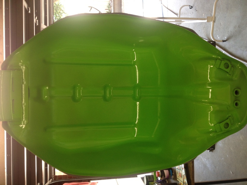

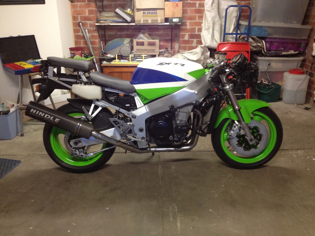

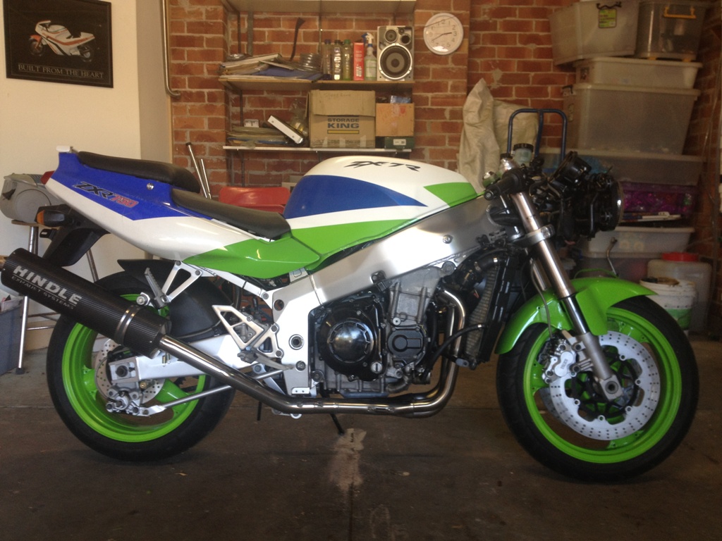

Another day closer thanks to JimZXR, upper rear cowlings.
The green on the tank is the new, off a code down at the paint shop, the only Kawasaki green listed & it's pretty damn close.

The pic did not show up for me before? Looking nice
Does it run OK?
Hopefully they will have a number for the paint code?

It's turned out pretty nice, it's far from concourse though, that'd be going too far, she'll be mechanically sound, reliable & fresh, nearly all the original parts have been cleaned up & reused, the bores still showing the hone marks & the valves were still within tolerence but we adjusted 4 of them to make it just sweet.
I asked the paint shop about the colour & he said that all the shops should have the same instructions to make it up. It's just Kawasaki Green, he only had one listed & said they'll all have it. I'm using 2 pak & it's a solid colour, so no clear necessary. The other colours, blue & white are bases & require a clear coat over. The green on the tank got a clear coat with the white & blue, just gave it a light sand.
I've never used 2 pak before, only acrylic lacquer & the 2k is the way to go, so easy & glossy, just make sure you cover yourself up, I did a bit in shorts & thongs initially & it was nasty, all sticky & irritable, now its a full suit & breather & gloves but I cant give up the thongs.
Sorry about the missing pic before, that was me rushing trying to do too many things at once.

The engine is perfect, just put a set of Factory pro jets & needles in her & also replaced the Pilot jets with 40#'s & oh so nice.
Paid a grand for her on ebay from a guy in Canberra.
Now it's warmed up I just have the fairings to paint & she'll be good enough for me.
She was worth all the work, everything was there to make it complete.
I'll post the finished pics as soon as she's done.
