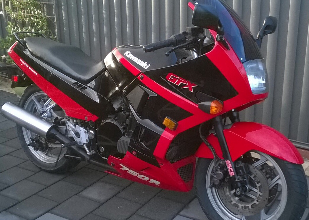

Re: GPX750 - project
So, 12 months or so later:
I have never attached photos before so hope it works.
Glynn
Glynn
