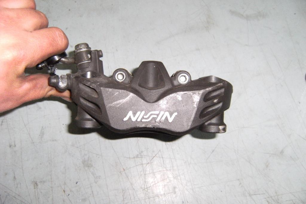

Thanks for the feedback guys :D, I think I'll be chasing a set of Nissin off a ZX6 or ZX14. Yesterday I got a price from a WA wrecker that wants $360 for a set, one of the callipers has some minor scratches on it (see pic below). Does that sound like a reasonable price?
