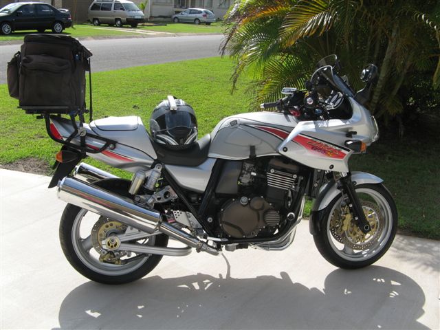

I've got the Rogue special on my ZRX, 4 into 2 system made up of ZZR headers ceramic coated and slightly modified, ZZR twin mufflers stock. Sounds good to me, looks great to me. Performance improvement, dunno but is nice and smooth.
Sydz Rex 001.jpg (72.11 KiB) Viewed 8543 times
Re: ZRX1200 exhaust system
twin pipes look mad!!! bet u clean it after riding in the rain!!!!
nice seat too!!!! corbin??? i think ill def be upgrading to a rex in a couple of years....

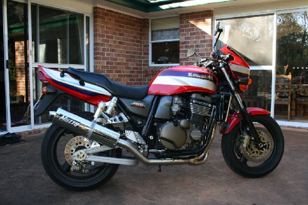

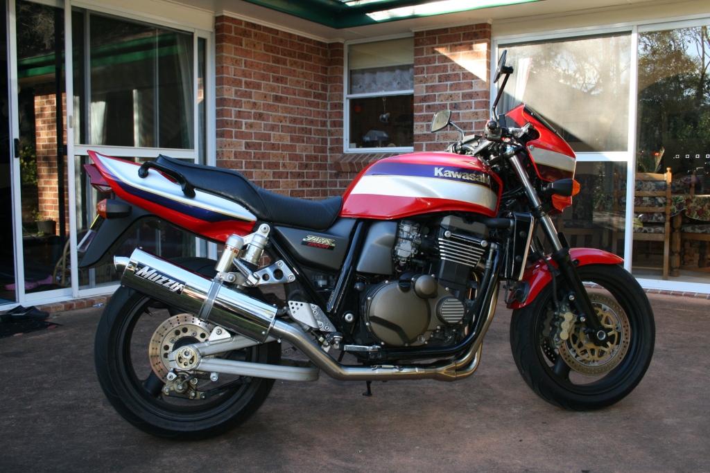

I recently bought a Muzzys stainless oval system for my ZRX1200 from Starcycle. Cost was AUS $ 900 including freight.
Runs well standard, but you could probably jet it better.

Roguedog wrote:I've got the Rogue special on my ZRX, 4 into 2 system made up of ZZR headers ceramic coated and slightly modified, ZZR twin mufflers stock.
What did you need to modify?

Bill,
Mounted ZZR12 mufflers on bike, drilled holes behind pillion footpegs to take bolts to support mufflers, then mounted header pipes (cut off mounting bracket for under engine) then plumbed header pipes to match up with mufflers, got a pro to do that.
You like the look?

Yeah, looks good! Anymore on performance?

Bill,
Dunno on performance, I'm not really into that. I've had the bike since new, done 40k now. I reckon it runs as good as it ever has, probably feels smoother if that makes sense.
