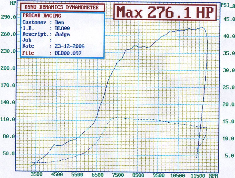

This is the printout for Judge ( for those that don't know it's a 1998 ZX9R C motor) 5500 is when it all starts happening,6600 it's making more than a standard bike makes at peak,theres a bit of a dip at 8500 but Im buggered if I can feel it. :D Then up to double standard power. Lot's of fun to ride with either the rear wheel spinning or the front in the air or both! :D :twisted:

Postby chuffed » Sat Jan 06, 2007 9:38 am
Thats a great result. Bet its a handfull on the street
weiloilbeefhooked
chuffed
Posts: 193
Joined: Sat May 13, 2006 3:09 pm
Location: Mackay, Queensland
Postby ty » Sat Jan 06, 2007 9:45 am
Probably less so that you'd think.
A 9 can get around on the street reasonably comfortably in the 4-5000 rpm range.
Looks to me like there's just hell more to go when you want to give it a bit of stick
