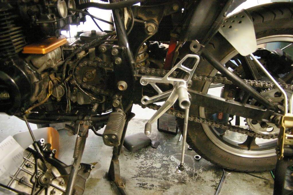

Eureka moment. ZX9 or ZX6 rearsets will almost bolt straight on. Some modification to the mounting points required. Miss by 3mm but nothing the welder and a drill cant fix. Gearbox spline the same and the change rod is of a suitable length. Since the MC attaches to the rearsets on the rhs then the original unit gets the arse along with 2.5kg of BHP's finest. Pegs move back 8" and up 2". Feels bloody good with knees bent no more than your average sportsbike.
Awaiting the clipons to see what the final positioning will be like but it should be ok.

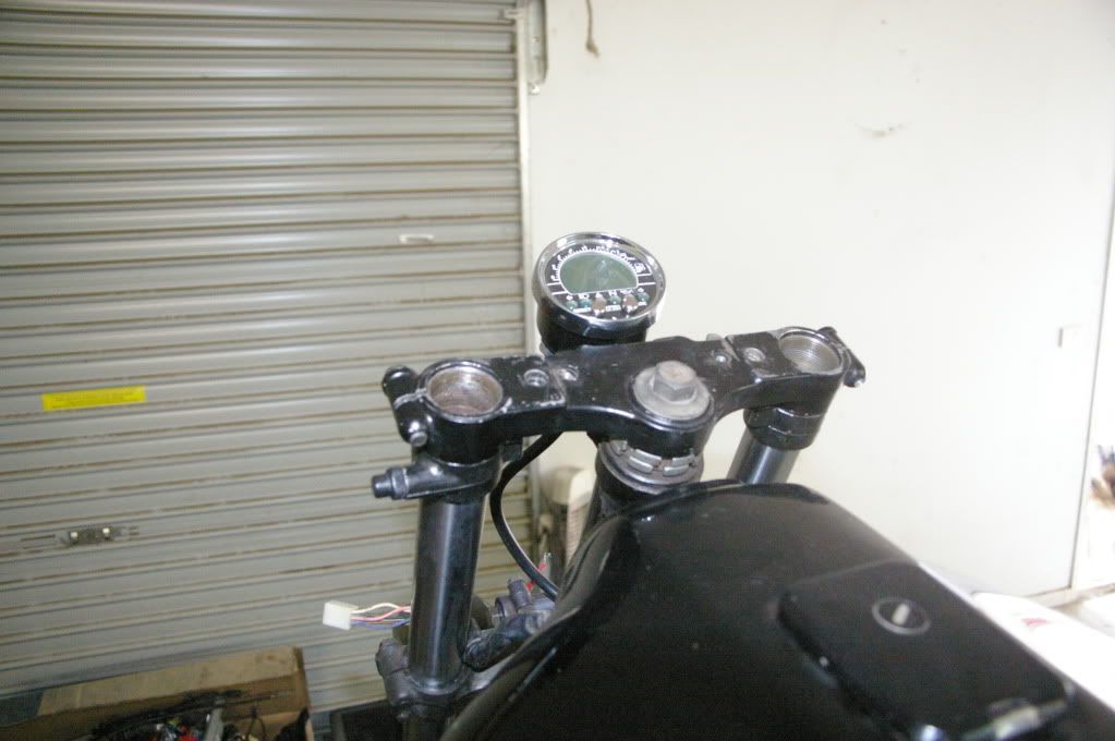

Acewell unit arrived yesterday and I have already sorted the wiring instalation for it but nothing will be chopped into or mounted until the clipons, lights, and switchgear are in hand.

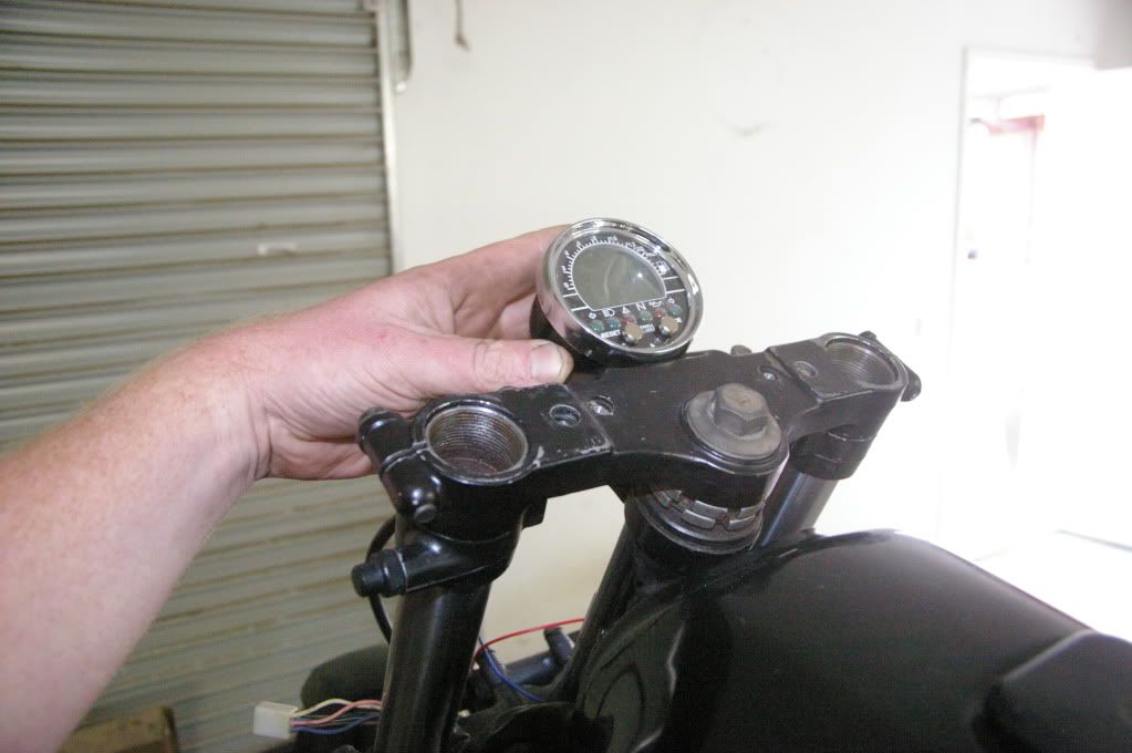

and against me big Ranga arm - this thing is tiny 70mm dia and performs all the functions of the original dash that was 220 x 90.

Rear sets off of the track bike vs original feet on the floor pegs.

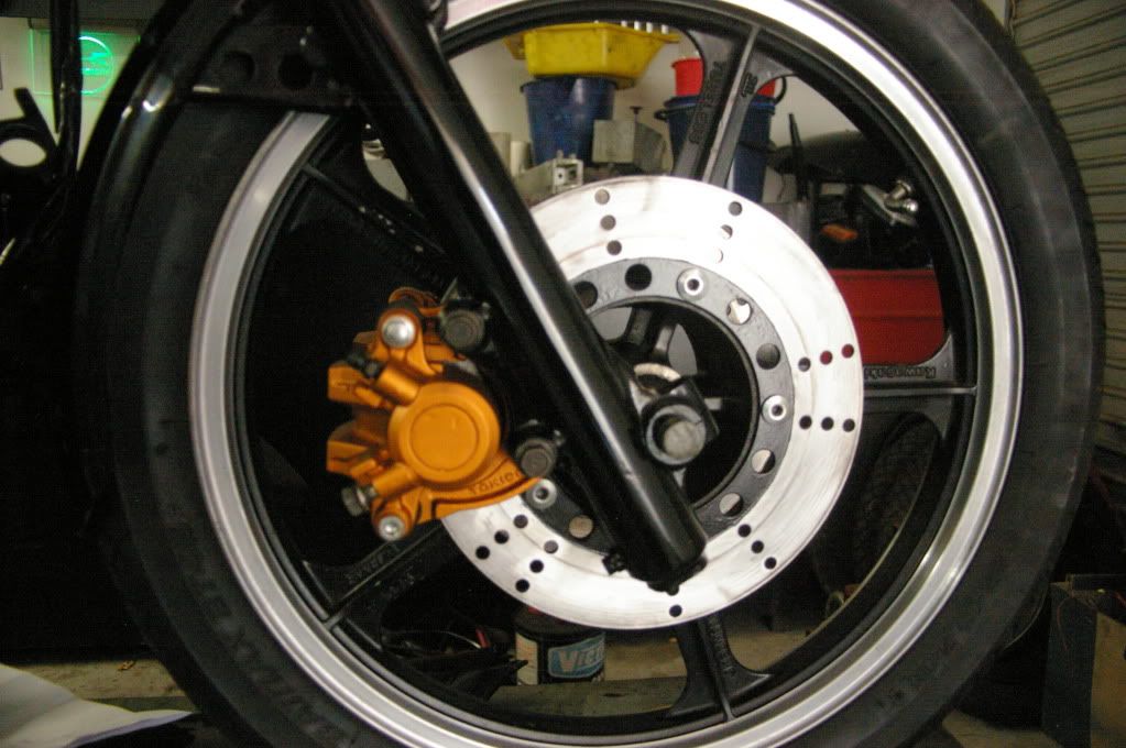

And the front end with more to come after removing the rust and grime from everyfink

Great pics there. I like the copper highlights.rattle can or two pack? are you going to fit the clips below the air balance tube or where the originals fit on?
rear sets suit it and im going to hunt down some zxr rearsets as per your suggestion

Rattle can VHT Burnt copper engine enamel - good to 650c. Calipers dont get that hot.davo231481 wrote:Great pics there. I like the copper highlights.rattle can or two pack? are you going to fit the clips below the air balance tube or where the originals fit on?

Clip ons will be mounted bellow the top triple and below the balance pipes unless its too low and then I will weld / blank the balance pipe. I have a set of cheapo chinese adjustable clipons in the mail that will allow me to adjust up,down, fore and aft before I settle on some good stainless ones....or if they are any good I'll keep them.
Those rearsets are off the 9 track bike and are different to original equipment on a 9 but the mount points remain the same. With lower set bars the riding position should not be far removed from sportsbike geometry....much better than the sit up and beg of 1982.
- the kid
- Posts: 3948
- Bike: Yamaha
- Location: Bendigo
Re: GPZ550 82H1 - THUNDERSTRUCK
No wonder they won't let you near those child care placesSlow and wobbly wrote:Givus a lollie first mister!
FMD , that Acewell thingo is tiny , but looks great . Quite suprised at how good the burnt copper colour looks , much better than thought .

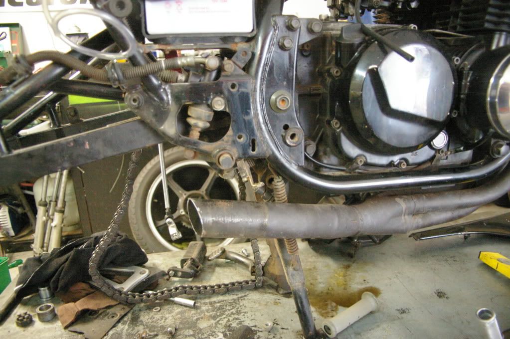

Spent some time on it today. Rear disc is undersize so will need to add that to the shopping list - thought it may have been close but the micrometer says it passed its used by .6mm ago.
Polished some bits and sorted the mounting of the rearsets. Using the zx9 rearsets means that I have to do away with the sidecovers as the rear MC will interfere with the RH cover. I was thinking of keeping them to retain the original lines that flowed from the tank to the seat but they will have to go. That also means the House brick of a battery has to go too.

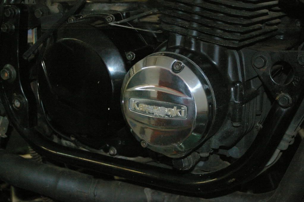

The damaged Kawasaki badge will be removed and the recess done in that burnt copper paint - old mate a few doors down has a vinyl cutter and "Thunderstruck" will go in there in place of Kawasaki.
Who says slash cuts are for HD's only? Loud and pleasing to the ear.
