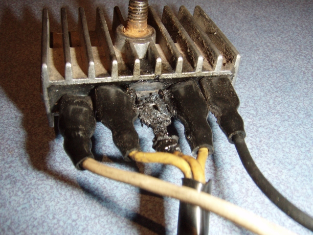

Mick C wrote:Bloody!!!!!! I'd been a naughty boy and had a blat up and down my street...noticed it seemed to bog down a bit and thought I'd check the timing now I had my timing light working again. Check it all and it looks sweet...then I notice the smoke pouring out from under the battery!!!!!! The dodgy rectifier decided to lunch itself and start to melt as fast as it possibly could with a lovely fizzing sound. Luckily it happened in the garage with the seat up so I could disconnect the battery asap and stop the burn before any flames started.
So there goes any chance of rego in the near future cos I'll be trying to source a new rectifier....and the B1 (and C1) had a different one to all the other 650's so they aren't too easy to get a hold of. I was hoping this was something I could replace down the line a bit. There are a few places though, but they are a bit pricey.
BLOODY !!! It might be a good idea to simply upgrade the entire electrical system ? I have a few alternators :oops: and the 750 stuff should bolt right up (including the rotor) - stand by for an inspection report from the 4th dimension (I can walk to both ends of the shed now :lol: :shock: )
While you were doing that walk, did you happen to see any shockies? or are you still panning through the bike parts for them?
Here's a quick pic of the damage...nicely toasted, and it's the one of the three that I had previously tested and found not working.

Well I finally got the replacement rectifier from the states, popped it in and it seems to be working nicely. The only possible problem is that all the extra voltage is kind of highlighting the regulator is probably not quite up to the job, so I'll have to keep an eye on it.
