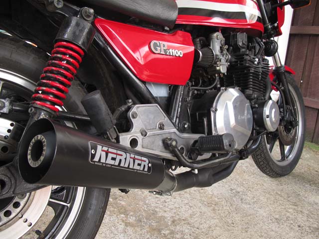

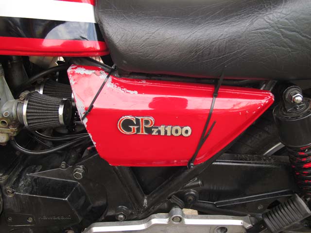

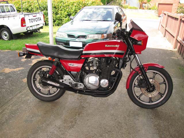

So here she is, took her for a ride today, wasn't the most successful
1. lost a side cover, turned round in time to see a car drive over it _ FAIL
2. Found a crack in my clutch cover and was spraying oil over my rear brake pedal... Will need to get another one
On the good side she is riding really well - the forks are gold and don't leak a drop and the motor is strong and quiet!! Can't wait to sort out the finally nigly bits. So what do you think of the exhaust?

The zorst looks great Jake...
When you get yourself a baffle, give me a shout and I'll tell you how to go about changing it.

that zorst looks the goods alright......shame about your sidecover though
- typical of all those old sidecovers though, I have lost count of the number of sidecovers I have lost and then retrieved......
Easy fix though - just use a 2mm drill, mark the mounting lug on the inside (while its fitted to the frame) - with some white-out or white paint. Take off the sidecover and you can see where you need to drill the hole - on the painted section of lug, as close as possible to where the paint stops - then use a small D-clip or a split-pin etc - placed through the hole once the sidecover has been re-attached. Bingo - no more lost covers. I normally only do the top 2 lugs, although you can do all 3 if you want. New rubber grommets help, but are not fail-safe......clipping the covers on is the best bet.

Ahhh yes... Good idea Gos! I was thinking of skinning the cat a little differently maybe getting a bit of metal trace, looping one side to frame - crimp it off and looping the other side to a hole drilled in the bottom edge... So I can pull them off with wire attached, but if they come of they'll be tied on!

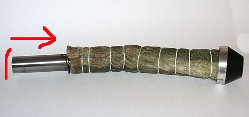

Re: My first bike show...
Once you have the tail pipe off...you will notice that the original baffle/insert for Gos
sticks out the bottom of the pipe.
Just hit the old baffle out from the front of the pipe ,using a piece of wood and a FBH.
Alternately ,just bang the tail pipe on the ground and the baffle will pop out.

Jacob - I just gave the long skinny end of the baffle - shown in red above in Dave's photo - a good 2 or 3 smacks with a piece of 4 x 2. This was plenty to get the baffle moving out of the tailpipe - once it starts to move it gets easier with each belt.
The new baffle should slide in pretty easily, just make sure you line up the hole properly so the screw at the end fits properly....the new baffle slides down inside the tailpipe a few cm.....and yeh, the note is *so* much better than what you get with a stock Kerker.
