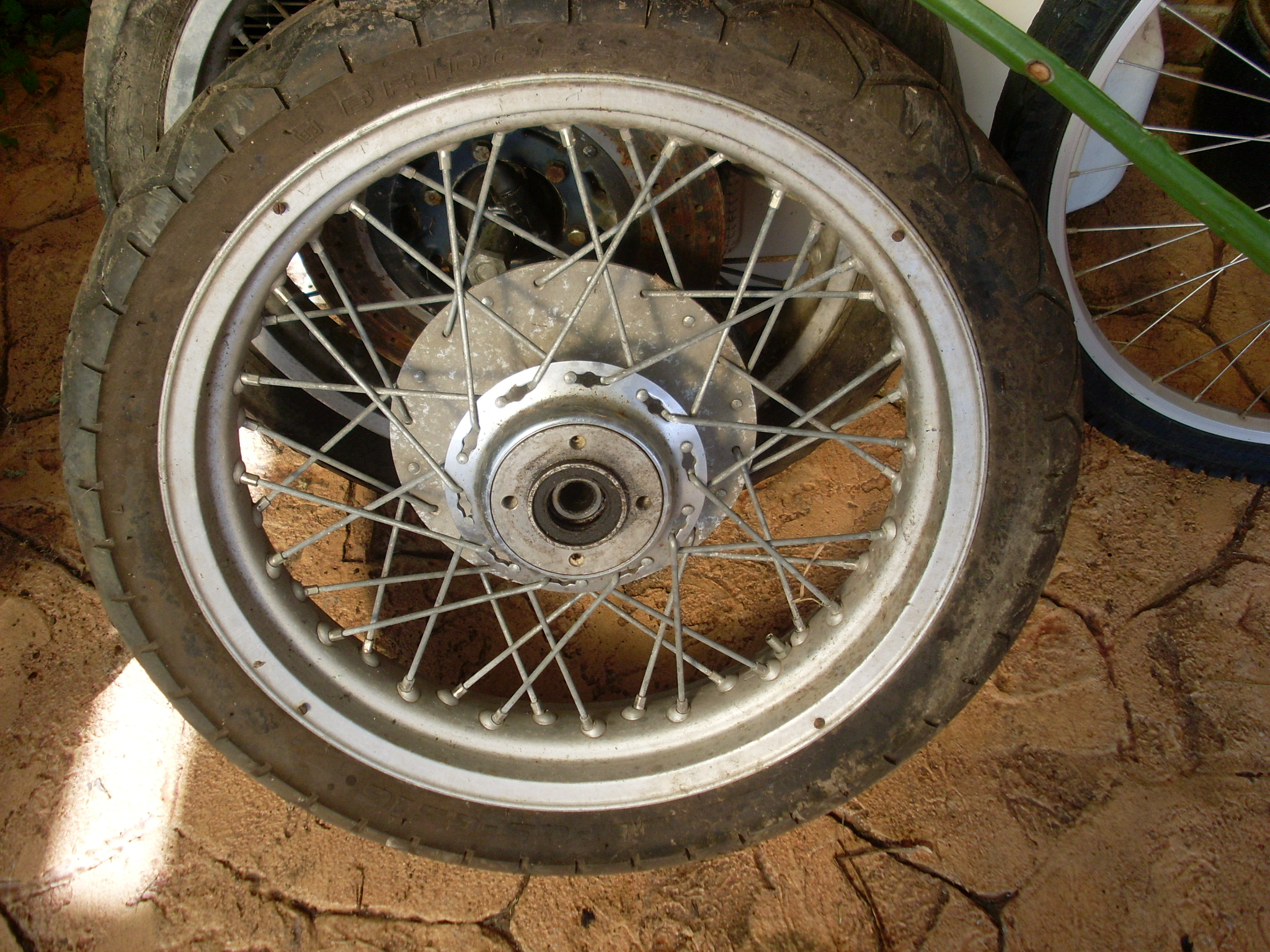

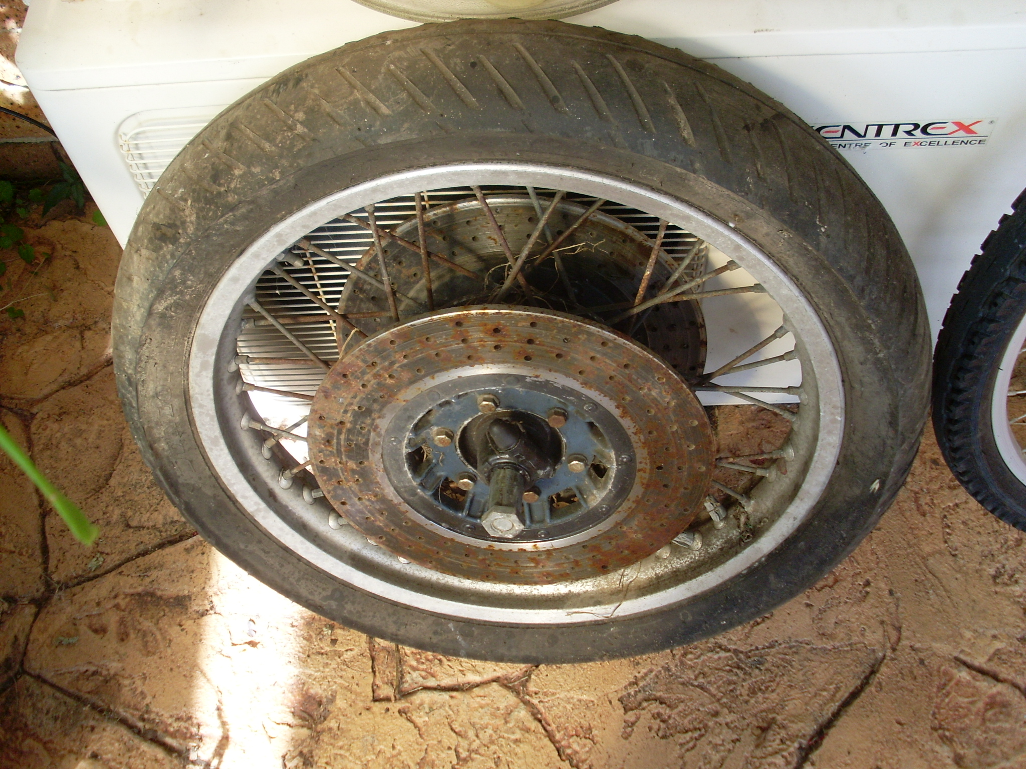

The front wheel is OK, but the rust on the spokes is just surface stuff. I took some light emery to one just to see and it came up pretty good. All the same, I'm taking both of them to Chivos in Sydney just to make sure they're OK to be used.
http://www.halltech.com.au/forums/Shado ... 370954.JPG
Rear wheel looks much better.

Phil - that photo of the front wheel - looks like Kent has used either a H2 or Z1 hub - it is a 6-bolt hub, not the later 4-bolt hub common to all the 900's and 1000's from 1976 onwards. What sort of condition are the disc rotors in ?

Disk rotors are fine, just a bit of surface rust. Not surprised that H2 stuff was used, several of the team had had significant dealings with the H2 before the Shadowfax project was begun.
Front disks
http://www.halltech.com.au/forums/Shado ... 370908.JPG
