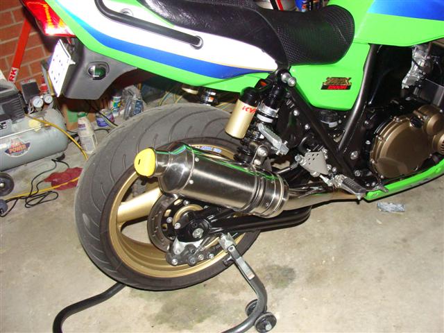

I need to stop reading this forum....
I heard voices telling me to start the grinder.....
I cut mine down also.
They told me size is not important....
But now its louder than Marty getting his back waxed...
Pick up the Factory Pro kit on Saturday.
- DSC01616 (Small).JPG (74.88 KiB) Viewed 2737 times
s man
- Posts: 809
- Joined: Sun Mar 14, 2010 7:58 am
- Location: Lake Mac NSW
Re: tune up
Man the things hangs low Scott. Are you sure you wont have ground clearance issues?? Or is the angle of the camara?

Na its the camera angle Steve.
Its the same angle & height as the standard number.
Its my Remus can cut down, its got the steell wool & the other stuff in it.
I went for a key in brain out spin in the city last night with a guy from work & it sounded pretty good in the concrete jungle...

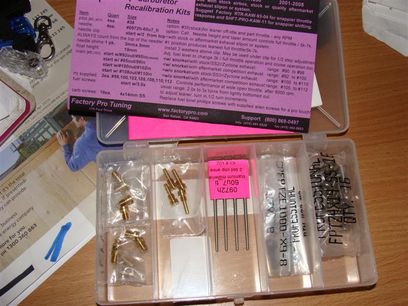

ezzazrx wrote:I've fitted a K&N filter to the Rex,and also cut the yoshi in half; i'm thinking I need to get the bike tuned up as she's burbling alot on the decel--- any thoughts apprieciated.
Hi Mate,
I can definately recommend MIck HOne and his Factory Pro jet kit if you want to go that way. My 2008 ZRX1200 has their " 1.1 kit with titanium needles, 38 pilot, needles middle clip (3rd from top), 100/102 mains, STANDARD air filter and standard length yoshi bolt on, you might want next size up mains as the K&N will flow more air up top. Mine pulls hard to 250k, is smooth everywhere else, still as good on fuel as standard or maybe better cruising but WILL use more if using the extra horses. Its a similar setup to what MCN did with theirs last year. To give you a comparison, my mate has identical bike but he is 20 kilos lighter than me, he could pull away noticeably in any gear when both stock, now mine is level with him up to 6 grand and then mine easily pulls away from his now. Yours will be VERY lean with K&N & the Yosh fitted, I would suggest dangeroursly lean, you need to take the plunge and re-jet (your Kwaka dealer or any good workshop can do it), dynoing it wont do anything other than prove how lean it is, so long as they check af ratio that is!
Hope you dont mind me sticking my nose in, i have been a mechanic for 30 plus years and i just hate people getting burned or wasting their time and money and not at least being armed with the knowledge up front. If your in Melbourne there are lots of good workshops, I have dealt with Mick HOne (a long time ago) and recently Phil Tainton (excellent bloke) or up in Sydney - MIck Dyer Motorcyles at Penrith is VERY knowledgeable but is old school and does not need/want a dyno.
hope this helps,
A.E.

I have had this kit sitting on my bench for a month now.
I will let you know how it goes when I can be bothered fitting it.

Cheers Scotty,I'm happy with the power however she may be to lean??, after Angry's tip I'll talk to my mechanic down here, let me know how the jet kit works out.
