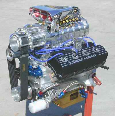

This one is just for Hemiduty.
Reckon you can find somewhere for it.
540ci Blown EFI Hemi - Daily drivable 1000+ HP on 93 octane pump gas.

Cheers Stretchy, I got just the car for it too!
And yes aspirated Hemis are awsome, there used to be an A/MS Roadrunner up in NQ which had a 426 in it. Man that thing was insane. Class rules said single 4bbl only, so this thing had a 2600 CFM Barry Grant special on it. Ran a Jerico 4 spd, and man it launched and wheelied like you wouldn't believe. Man that car was cool.....
