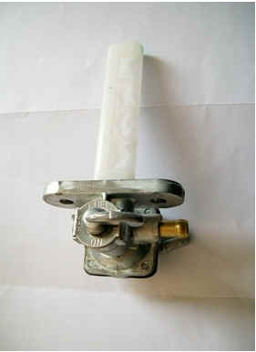

It's the duck's guts, all right. It just never ceases to amaze me that, the more you you do, the more obvious it becomes just how tough and rugged those old Z motors were. I mean, if that was a modern engine, it wouldn't be fit for scrap. Fantastic work, mate. Here's a couple of more pics taken from an email that Kent sent me last night.
This is the tacho that Kent used on the bike when it was being used as a road bike. A GPZ-item (I think).
We need a fuel tap like this one for the fibreglass tank. Any help would be gratefully accepted.
Keep up the great work, Dave, I'm more indebted to you than what I can ever say.
