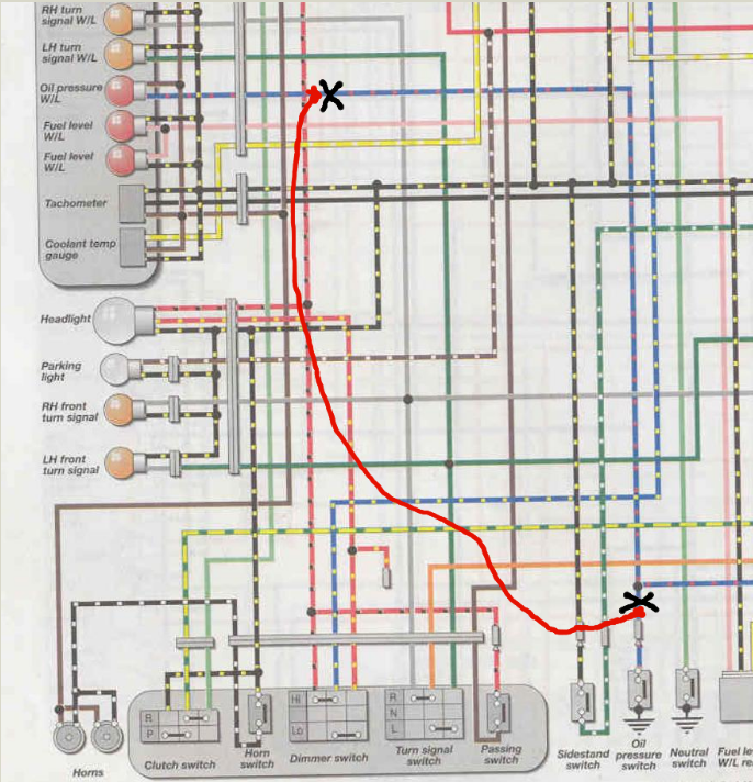

Hi all I have been slowly putting my old 88 modell gpz back on the road and have everything done except for one thing. Im having a problem with the oil warning light obn the dash, it stays on constantly. Oil level is good but even if I pull the wire off the the sender the light on the dash stays on. Im not that graet at electrics so go easy on me if you have any ideas....think ....''Bike Electrics for Dummies''. I tried rerouting a new wire from the sender up to the plug at the dash to bypass any issues but the light goes out and stays out, not want you want. I have pulled the sensor cleaned it up and its working ok i tested it with my basic multimeter and it seems to be good. I am assuming the light on the dash would go out before start with ignition on f the wire at the sender was disconnected as this would simulate the switch shutting off once oil pressure had been achieved, is this the case?

Generally the oil pressure switch supplies the 'earth'. So your circuit is shorted to earth somewhere where after the light and before the switch. Start at the light and follow the wires till you find it?

Postby BrettZZR » Tue Dec 10, 2019 12:55 pm
You don't want to bypass the switch - you say it's working?
Find the wire coming from the oil light, and...
See pic...
This diag is from an early ZZR - you *may* find the wire colour (Blue with red line) is even the same.

Postby grytvikken » Tue Dec 10, 2019 10:43 pm
BrettZZR wrote:You don't want to bypass the switch - you say it's working?
See pic...
When I say bypass I mean the bypassing the dodgy wiring , i still want the light to work as designed

Postby BrettZZR » Wed Dec 11, 2019 4:41 pm
grytvikken wrote:... When I say bypass ...
Then do as per drawing. Don't forget to cut the dodgy wire out of the circuit (black crosses).

Postby grytvikken » Sat Dec 14, 2019 10:35 am
Sorry for the late response been full on with work ...I have tried your idea and it doesn;t help im afraid. light goes out totally and stays out. thanks for your idea though.

Postby BrettZZR » Sun Dec 15, 2019 1:44 pm
Trace the voltage step by step... You *have* to find the problem.
