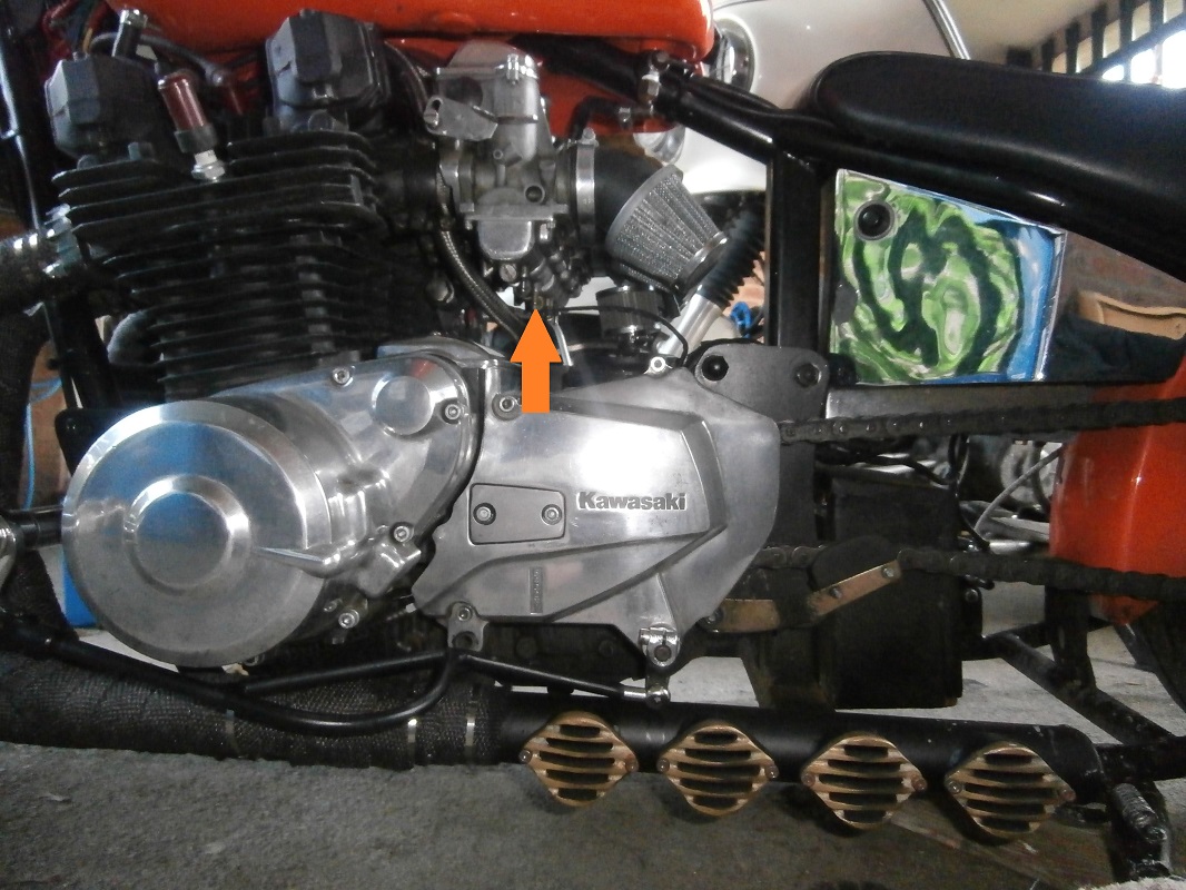

My '82 GPZ1100 started peeing fuel out of the #2 carb. It comes out of the bottom drain when the engine is running.
Only started on the way home last night. Could it be the throttle slide that is stuck? :?:
Thought I'd get some feedback :prayer: before I started stripping it in case I needed to order any parts.
