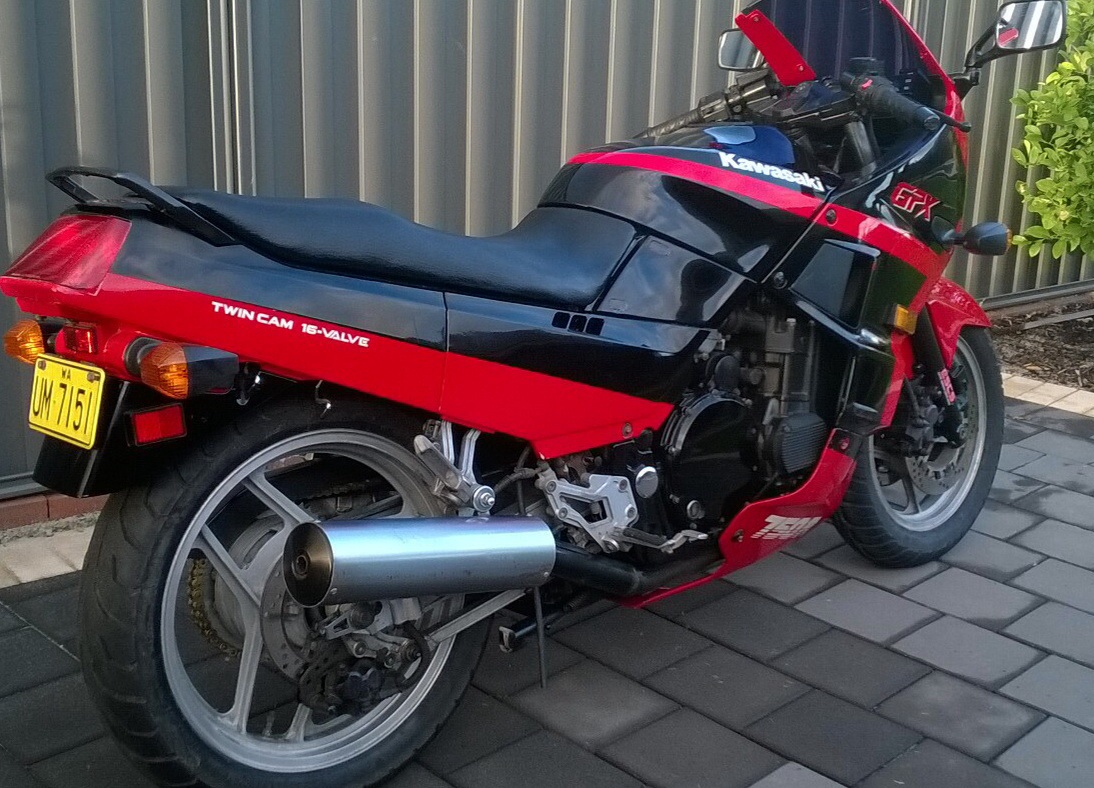

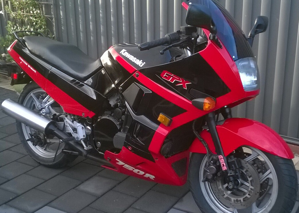

Postby glinno » Sat May 31, 2014 3:47 pm
So, 12 months or so later:
I have never attached photos before so hope it works.
Glynn
