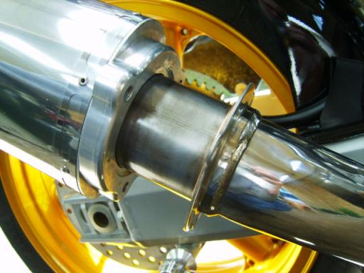

Postby Phoenix » Mon Jan 13, 2014 3:33 pm
Photo showing muffler fitted as far down onto the headers before the internal baffle contacts the end of the pipe. Note, there is still 54mm to go before it is supposed to mate up with the pipe flange.

Postby kawadave » Mon Jan 13, 2014 4:11 pm
I can see your problem now...
If it was mine I would probably cut the pipe with a hack saw to allow the muffler can to slip into the flange.
But I guess you bought the slip on to slip on without any modification?

Re: Scorpion Muffler on 2000 ZX-6R
Postby QQQ » Mon Jan 13, 2014 4:15 pm
Angle grinder with a cutting wheel would have sorted that in about a minute :D

Postby Phoenix » Tue Jan 28, 2014 7:08 pm
UPDATE II - Scorpion decided it would be more cost effective to just send a replacement item. After checking dimensions I provided, a new muffler arrived today and a quick trial fit to check if it fits.......IT FITS!!!!!
Thanks Scorpion - Great customer service and a bloody good looking muffler too. Excellent customer service... HIGHLY recommended.
