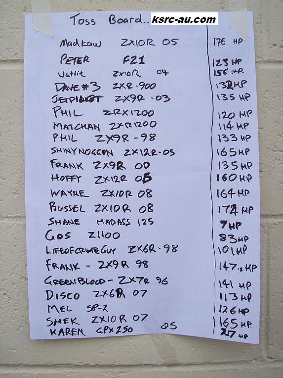

Postby Slow and wobbly » Thu Nov 11, 2010 7:49 pm
Interesting to note that the C Model ( earlier ) was putting out 147. What were the differences between Franks vs Phils (133).
Point to the thread if there is one.

Postby Wattie » Thu Nov 11, 2010 9:23 pm
Slow and wobbly wrote:Interesting to note that the C Model ( earlier ) was putting out 147. What were the differences between Franks vs Phils (133).
franks 98model is not quite stock mate. :lol:
its got some head work, and possibly some cams? Madkaw will fiill in the gaps its his ol bike.
It does Honk thats for sure. 8)

Postby MadKaw » Fri Nov 12, 2010 9:03 am
Yess, that zx9r does honk... I lapped almost the same on that as I do on the zx10r.. but thats probly age related, I was younger then.. :-)
Its got a few bits on it...
Full Akro race system
Factory pro jet kit
Factory pro iginition advancer
Heads been match ported and shaved
Kleen removed
520 chain and sproks...
BMC race filter
(std cams)
Other stuff not HP related, but the gearbox is undercut, has Factory Pro shift kit, ohlins shock, ohlins fork internals and damper..
Had the shortest Domino throttle on it too, but Frank took it off... :roll:

I still have it, but sick of the scrutineers at track days continually telling me it was a high side throttle!

Postby gman017 » Fri Nov 12, 2010 7:54 pm
Interesting read on the board, quite a variance in some of the power levels. Makes 137 look pretty middle of the road.
The guy who dyno'd my bike offered to put a jet kit in it etc but it already exceeds my riding ability :oops:

Postby Phil » Sat Nov 13, 2010 10:41 am
Mine had full Akra system, std carb settings as they came from the factory - no jet kit, std filter with mesh still in and 126000 k's on it. ;)
Re: zx9r dyno
Postby Wattie » Sat Nov 13, 2010 12:04 pm
And all dynos are different
Posts: 10041
