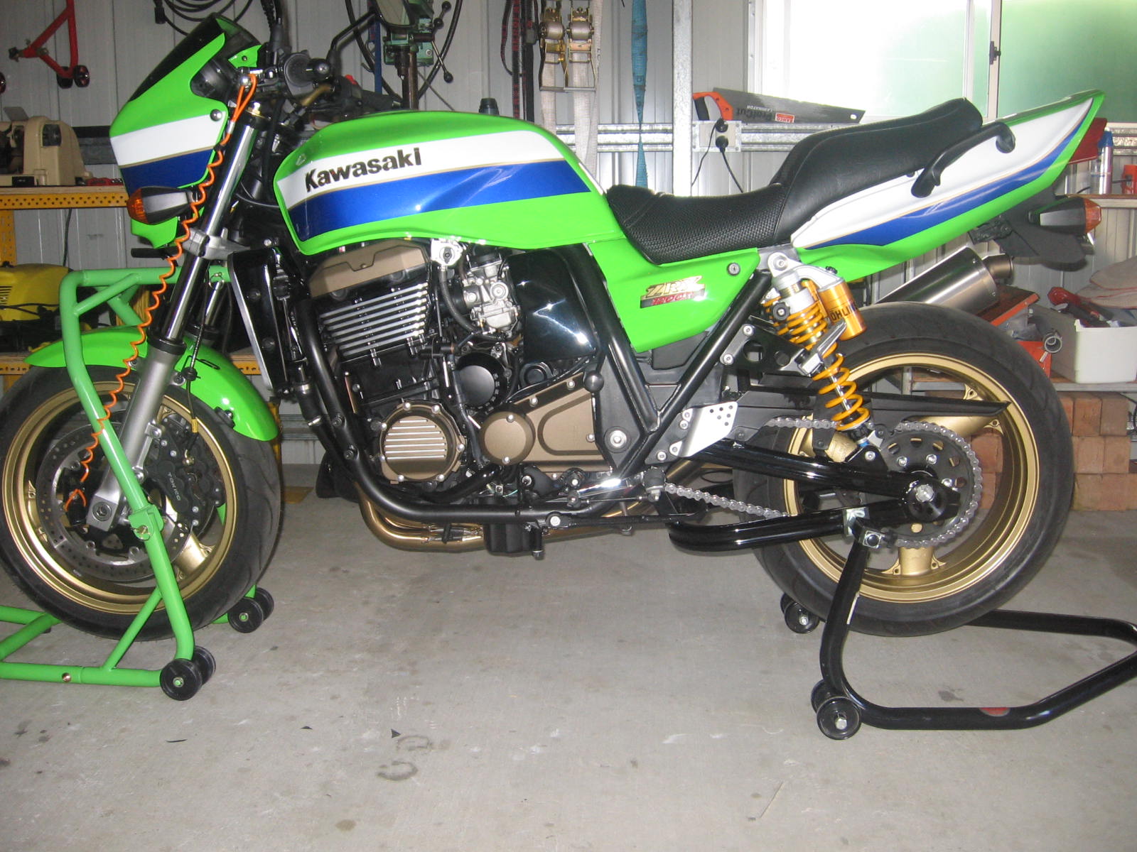

Shocks finally arrived, well worth the wait and just before the next price rise. They say something like $1945.00 a pair :shock: from now on. Thanks to jim at zenodamper, excellent price and service.
lastzed
Posts: 12
Joined: Fri Apr 11, 2008 7:02 pm
Bike: GTR
Re: Anyone been following the AMCN ZRX1200?
Postby hoffy » Mon Oct 27, 2008 6:00 pm
You ass-bandit !! :lol:
Postby rooster » Tue Oct 28, 2008 7:58 am
Nurse some just posted suspension porn on the interwebby thingy can I have my blue pills now :D :D :D
