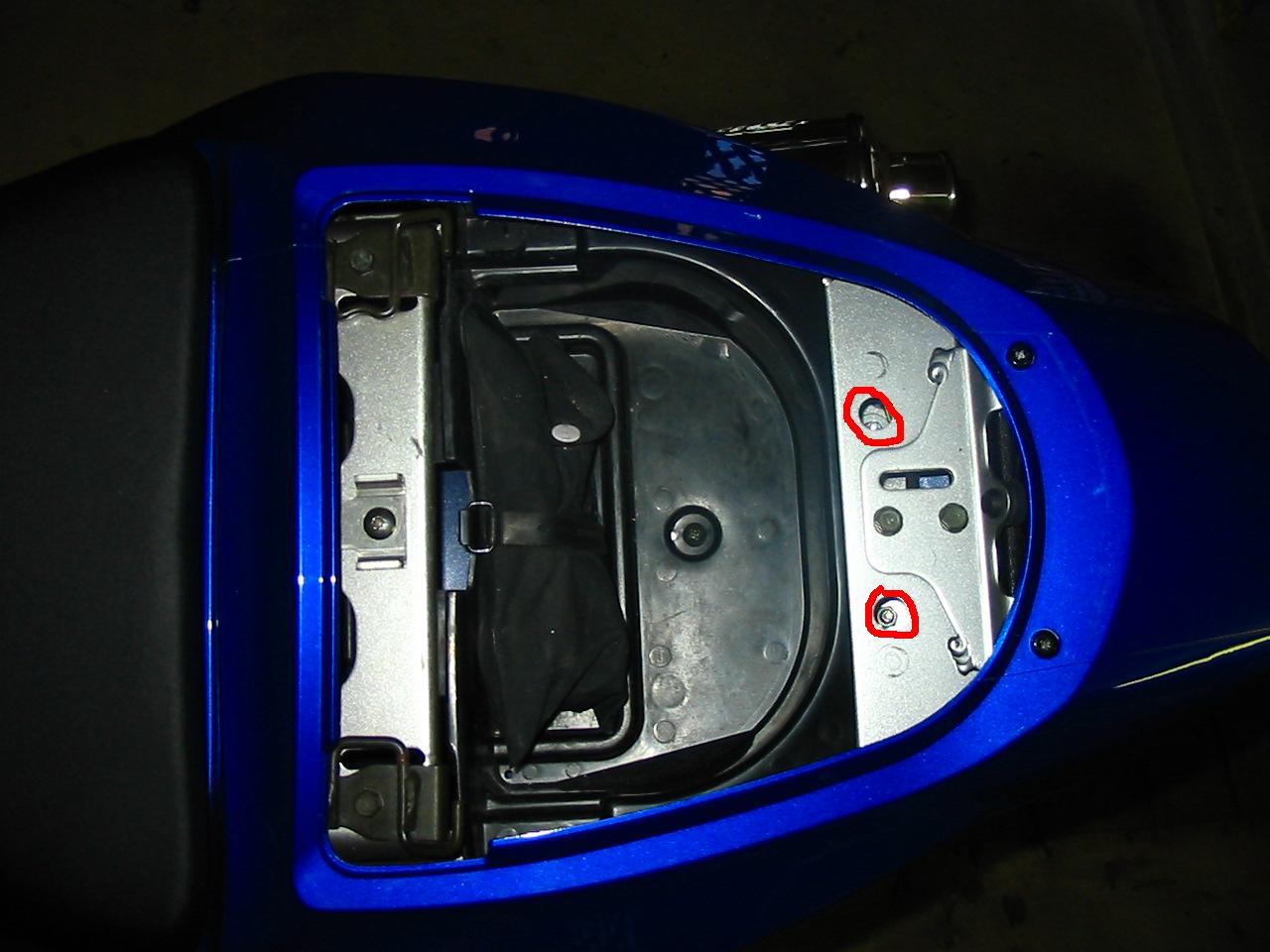

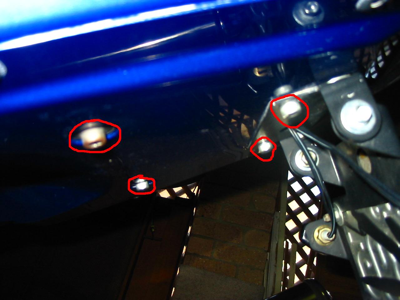

gday guys, been checking the forum out for a while now, but seen as though i just bought a kawasaki i thought it was time to sign up.
heres my problem: need to remove fender eliminator for roadworthy, but it seems to have the better of me, fiddled around a little bit and decided to not muck around too much until i know what im doing. i cant seem to get to the top of the bolts where the fender eliminator joins the tail, i hope my dodgy paint exercise tells the story.
top view: need to get rid of the storage comparment to get to the bolts - how?

Postby Plaz » Wed Apr 12, 2006 6:01 pm
Mate when I did ym 03, from memory you need to remove the whole rear duc tail and then you can remove the plastic tray that holds the tool box to get at the offending bolts....wasn't hard to do as i recall

Postby red_dave » Wed Apr 12, 2006 9:11 pm
I agree with Plas on this one... I'm pretty sure the whole ducktail had to come off...

Postby Plaz » Wed Apr 12, 2006 9:34 pm
duck tail is pretty easy, front seat off, then follow the screws and push pins 8)

Postby SenNey » Thu Apr 13, 2006 11:47 am
Yep remove the who thing, we had to remove it to fit hubbys ventura rack.
Takes around 10-15min to remove.

Postby fitzy » Thu Apr 13, 2006 5:11 pm
thanks for the help guys, all sorted now. not too hard to do, just a bit of a pain in the ass.

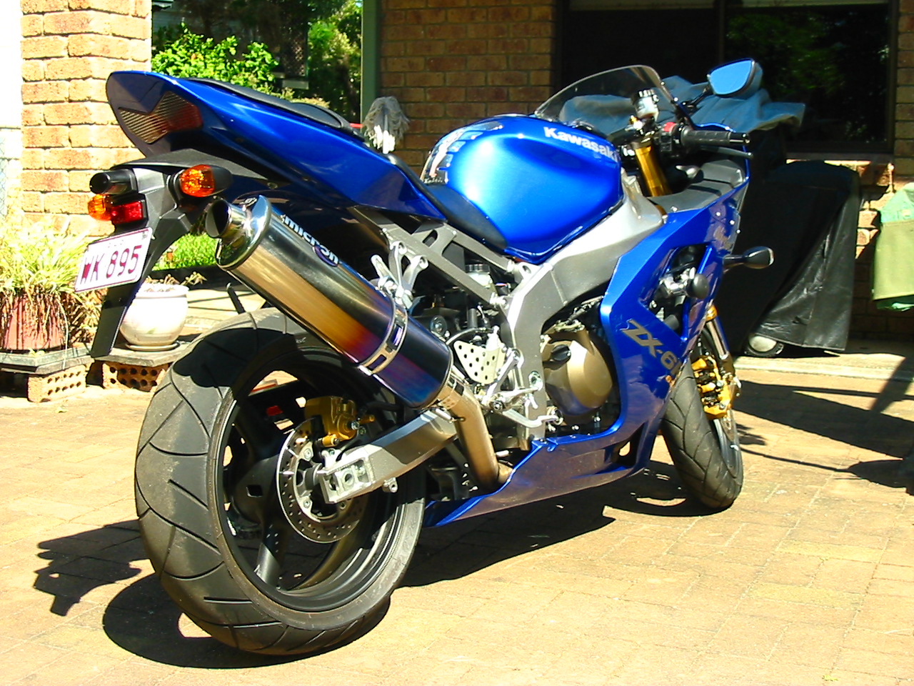

Postby fitzy » Sat Apr 15, 2006 3:50 pm
so all is well now, roadworthy is done. dont know if i can be bothered putting the fender eliminator back on, i'll see how i go. anyway here is a pic to satisfy plasmablue636
