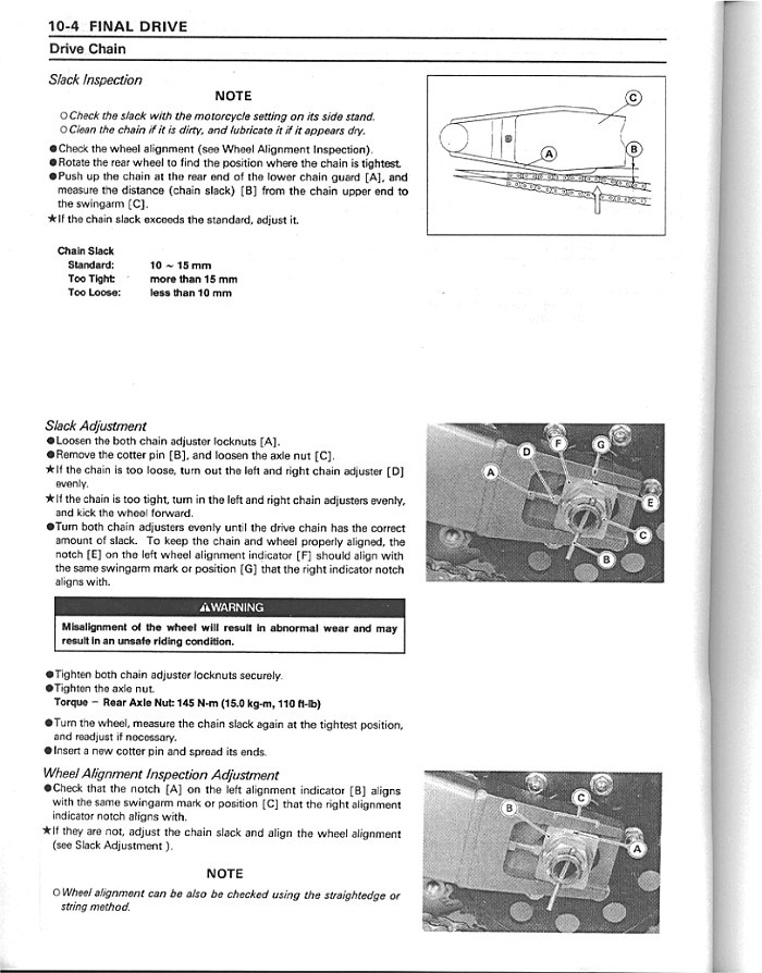

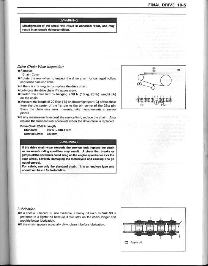

Postby Smitty » Mon Nov 28, 2005 8:12 pm
some bits from the manual
