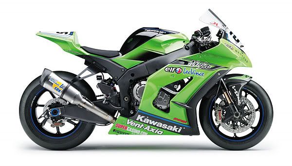

Postby MAXUMIS » Thu Sep 09, 2010 9:33 pm
i just found a 10r site that had pictures on how to do it it does look like a bit of a pain in the arse for the 10 but well worth it they also had a picture of the new world super bike 10r it looks awsome

Postby Gosling1 » Thu Sep 09, 2010 9:44 pm
thanks !! that will be the new paint scheme for the MFP12 !!
Got any more photos ?? or just the link to the site would be enough..... :P :P :P
