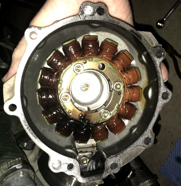

- 2010zx6r
- Posts: 164
- Joined: Sat Dec 25, 2010 10:25 am
- Location: Melbourne
Re: Shorted stator. Other damage?
Heres my progress so far.
Stator is faulty and was shorted to ground.
peter stevens wants over $300 for one of these. [CRYING FACE]
