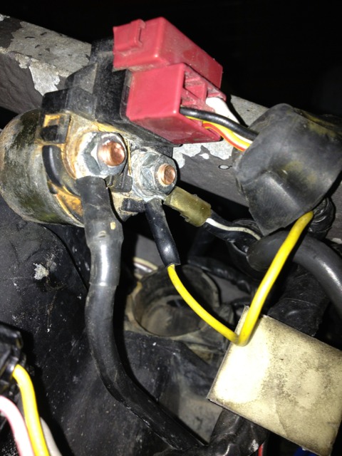

My ZXR has unfortunately had the starter solenoid plug butchered & someone has fitted a starter solenoid off a spaceship so I need to correct it & fit the brand new OEM solenoid that I have, I have a few different wiring diagrams but they dont actually show which wire goes to which of the 4 connectors?
Could someone please take a pic of their ZXR 750 (Preferably 93-95 L model) starter solenoid & wiring connector so I can see which wire goes to which on the 4 connectors on the solenoid
Muchly Appreciated

I just finished off the battery mount & got the battery & wiring back in place, I have a new starter solenoid sitting in position & I just need to know what wires go to the 4 connectors? The solenoid is clearly marked with a B for battery & M for starter motor for the larger connectors & cables that part is easy, As mentioned the 4 pin plug has been removed so I dont know which wire would go onto which of the 4 connectors
My bike is sitting here ready to fire up with a new Lithium Ion battery & a brand new solenoid so im keen to see how it cranks over now
If anyone can get some clear pics of the starter solenoid & the 4-pin plug showing which wire goes where it would be great

Sorry this has taken so long mate, been a bit busy but here goes;
Re: ZXR 750 L STARTER SOLENOID WIRING
Posted: Tue Feb 05, 2013 6:04 pm
by NINJAINOZ
Wow thanks Jim, Thats a big help to me & possibly others with similar trouble? I was sure the 4-pin connector only had 3 wires because there was only 3 wires coming out of the harness in that spot after I tidied up the butcher work that was done to it previously, Im pretty fussy so I am going to get the wiring back to original wherever possible even though it is being built as a streetfighter
