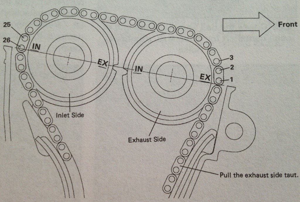

We are restoring a zx7r from the ground up & started with a basket case as far as the engine goes Weve stripped it down & its like new inside, very happy, But weve struck a funny thing with the cams. When we set up as per the book, TDC on #1 & 4 & lign up the ex & in marks on the cams & set them 26 links apart the mark on the exhaust cam is slightly out( doesnt line up perfectly with the top of the head) very odd or is that normal?
Weve checked the chain for stretch but like the rest of the engine its perfect, has anyone struck this before?
I like to know its right before we reinstall it into the newly painted chassis so we arent doing it again. Ive ordered a Haynes service manual from UK but probably take a week or 2 & I'm trying to get her back on the road by Christmas

Extract from my manual:

Thanks for going to that trouble,
Still unsure though, our dilemma is that when lined up similar to that in the above diagram we end up just off the crankshaft mark maybe what would be about half a link ??
Nothing seems to just line up perfectly, strange.
The service mechanics must hace come up against this when doing the valves, wondering which mark we disregard, its possible the crank mark is not right but seems right when we use a screw driver to feel TDC
Are there any Kwakka mechanics out there that know what to do ?
Regards
Mitchell

Remember that the chain stretches over time - and they still run fine - so I don't think it needs to be absolutely precise in the beginning.

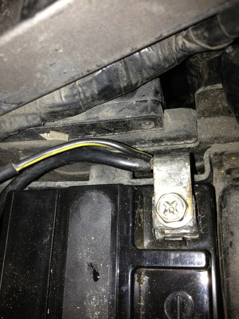

Have just looked at the loom on my trackie and Gos has it spot on!
One side of the wire is connected to the battery negative, the other to the frame via a shared bolt on the fuel pump bracket.
Shot of the battery end below but can't get a clear one of the pump side.

The open ended (fork) fitting goes onto the battery negative, the other goes on like I deacribed above!
Hopefully that sorts it but not sure why that'd affect the starter motor as the motor is also connected to the battery negative!
