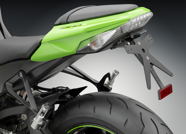

Licence plate kits/ fender eliminators (for the americans),
looking at one to tidy up the tail section of my ZX10R, but what are the coppers likely to say about it(NSW), i know they can be tough at times- can they ping me for one or are they completely legal??
Here is a pic of one i am looking at.
Thanks for any experience/info
Kel
Kel

Indicators 12" apart is ADR requirements for starters

ADR states bottom of tail tidy must have a reflector, and be 45 deg from the wheel nut.

ok, so the measurement between the two bottom holes is 157mm which is 6.2 inches, even giving another inch for both sides combined as the indicator stalks are a little wider this is shorter than the regulation 12 inches.
not worth it? or do they turn a blind eye to it??
this one has a reflector, i like them but if it gonna give me grief it's not worth it then.

well its got the red reflector may be a tad shy of 45, but it looks pretty good tho.photomike666 wrote:ADR states bottom of tail tidy must have a reflector, and be 45 deg from the wheel nut.

I'm not sure how the 12" indicator apart rule is applicable to a bike that comes factory with indicators intergrated into the tail section.
The bike is complianced with integrated indicators, along with dB reading stamped on the plate in aus.
If a cop defects you for integrated indicators, in essence he/she is defecting kawasaki Australia.
Cali state law is different, hence the bike comes factory with non integrated indicators.
That tidy tail insinuates that your indicators have been relocated, avoid.
That's correct, still need to satisfy this, if your an OPH regular, perhaps avoid, they have been stinging tidy tails/no reflector as of late with the blitz; so Ive been told.ADR states bottom of tail tidy must have a reflector, and be 45 deg from the wheel nut.

Lucky your not in victoria this is a capital offence and u would definatly be booked no matter what, just because they do.I was defected when my reflector was on my guard and it was 45 degress from axle but as some of the guard had been removed they pinged me.It was legal as i went to vic roads and had it removed without question.bottom line is the coppers attitude.

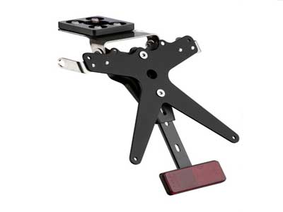

blackster wrote:I'm not sure how the 12" indicator apart rule is applicable to a bike that comes factory with indicators intergrated into the tail section.
The Rizoma comes with optional adapters for turn signals as it is sold worldwide,so the adapters can be added or removed for the U.S as they require indicators further apart as stated.Note on this pic from the website no indicator adapters.
quote: Kawasaki Rizoma License Plate Kit for ZX-10R (2011+)
Rizoma's new fender eliminator and license plate bracket will clean up your bike's tail section. The fender eliminator includes a license plate light, plate bracket, and optional adapters for aftermarket turn signals. This kit does not include any turn signals. The plate bracket is hinged for tilting, and has a high level of adjustablility.
This very beautiful and elegant kit cleans up the tail section by removing the huge stock undertail license plate holder assembly. License plate bracket articulates so you can get the correct angle that will complement you bike's form. Perfect fit with a very simple install using minimal tools. The plate frame shown below is for a Euro license plate. This kit will include a US plate mount. This kit will fit your Kawasaki ZX-10R.
- rizoma_kawasaki_zx10R_05.jpg (105.94 KiB) Viewed 3164 times

You'll end up having to hacksaw the two lower arms of that base plate with that kit, our number plates are not UK styled in length. How about the width, does it come with adapters to suit?
I know with the evotech they give you universal adapters to fit aussie plates. A stick on rectangle reflector is provided in the kit, need to use your ingenuity though to fit; there is no fixed base to fit it to other than the number plate.
