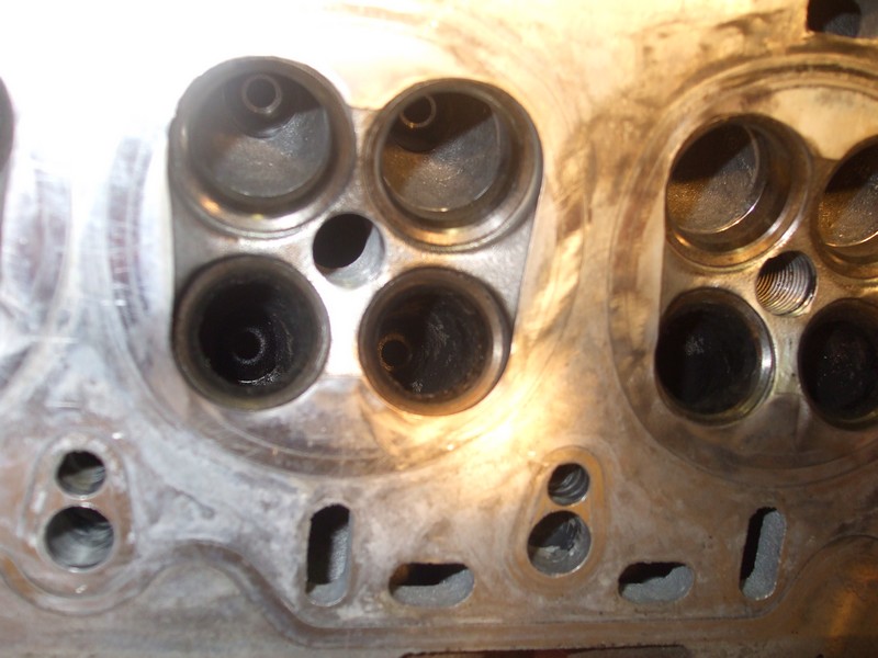

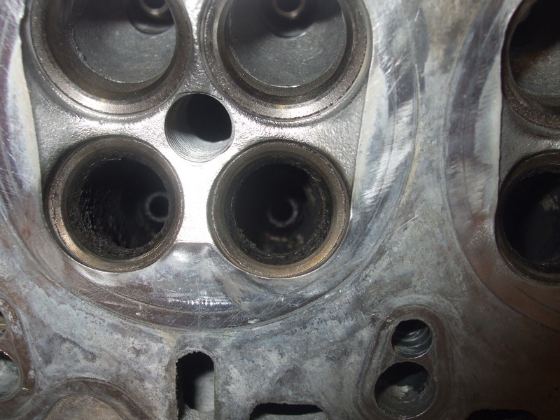

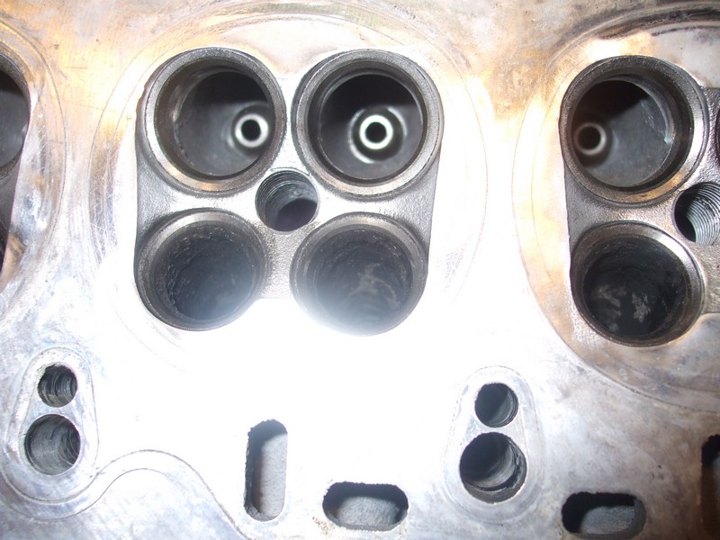

Hi all, I'm finally getting around to rebuilding the engine on the ZXR250 and I'm currently up to cleaning up the top end. I've pulled out all the valves and there seems to be an extraordinary amount of carbon built up on the exhaust side. Never having gone this far into an engine rebuild, what seems to be a large amount of carbon, might actually be normal. On 3 of the cylinders, the carbon also looks quite oily. What I want to know is, does anyone know why some of the buildup looks oily, what can I do to fix it, and is this a normal amount of buildup. Keep in mind that its a '92 C model with an unknown amount of k's on the clock (I think it shows around 50K). I have always run 98 oct through it, with regular servicing. I know that the high octane fuels will cause carbon buildup if the engine is constantly used at low revs, however this thing has been flogged to death since I bought it. The valve seats appear to be fine with no pitting or burning, and thats about as far as my expertise goes. A couple of pics attached, not sure they show the buildup real well but they give the idea.

carbon build-up in the exhaust ports is entirely normal mate, and that looks like normal build-up to me. You could go to the trouble and expense of having the exhausts cleaned right out of all carbon build-up, and polished (to reduce any further build-up) - but honestly, its a waste of money on a small hp bike like a 250.
The important things are condition of valves and valve seats. If these are good, and the clearances are still able to be set in the middle of the range - then all you need to do is check if there is any excess play in the actual valve-stems, and replace all the valve-stem seals as a matter of course.
